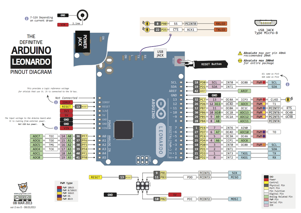

I own a BC118 BLE Mate2 and an Arduino Leonardo, i’ve try to follow the Hookup Guide to establish the wire connection, but i can’t really figure how to make the hardware connection, since the example presented in the Guide doesn’t use a Leonardo Board. I also don’t use a FTDI SmartBasic , though there shouldn’t be any problem, i’m aware that i have to disconnect the BC118 every time that i’m flashing Arduino and i won’t be able to use Serial Debug, but that’s ok.
So far i wired the GND and the VIN wire, there are 4 more wires to connect : CTS, TXO, RXI, DTR.
Can anyone tell me specifically how this wires should be hooked ? All i know is that the wires should be connect to the serial pins, but which ones?
