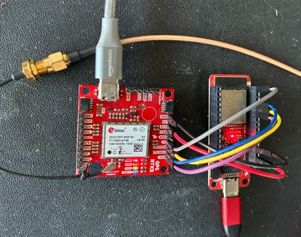

The HW setup is simply a MCU (thing plus esp32 s2), a dual-port shield and a gps (zed-f9r or f9p)

schematics is very simple:
just the Thing Plus ESP32-S2 connected to the other two boards, besides 3V3 and GND also I2C (needed for SD first change to SPI..) and SPI.
also some led on IO11 and IO12 and a button on IO10.
as said this works fine with the ZED-F9R but very bad or almost never with the F9P.
how you see in the code the CS_GPS is IO06 and CS_SD is A5 (you are correct is IO05).

The direct connections, e.g.
DSEL soldered on GPS-RTK
(MCU) - (GPS RTK)
GND–>GND,
3V3 → 3V3 and
? → CS
COPI → RX/MOSI
CIPO → TX/MISO
SCK → SCK
then your code.

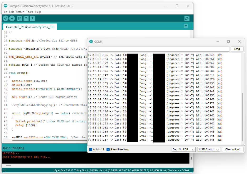

Please follow this link for our simplest SPI example - using v3 of the library. Please note that the example disables NMEA output on SPI, leaving only UBX enabled.
I don’t have an ESP32S2 board here, so I can’t fully replicate your setup. But I have tested this example many times on other boards, standard ESP32 (usually the “SparkFun Thing Plus C”) included.

Your pin connections are correct. The F9P breakouts have an on-board 3.3V regulator, so you can instead link 5V → 5V to provide power. But 3V3 → 3V3 works too.

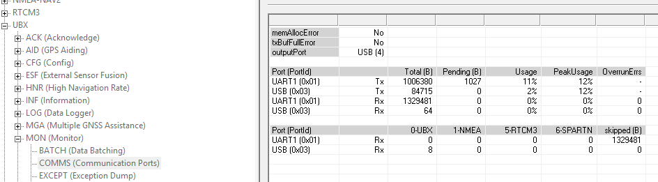

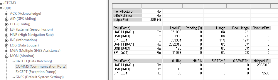

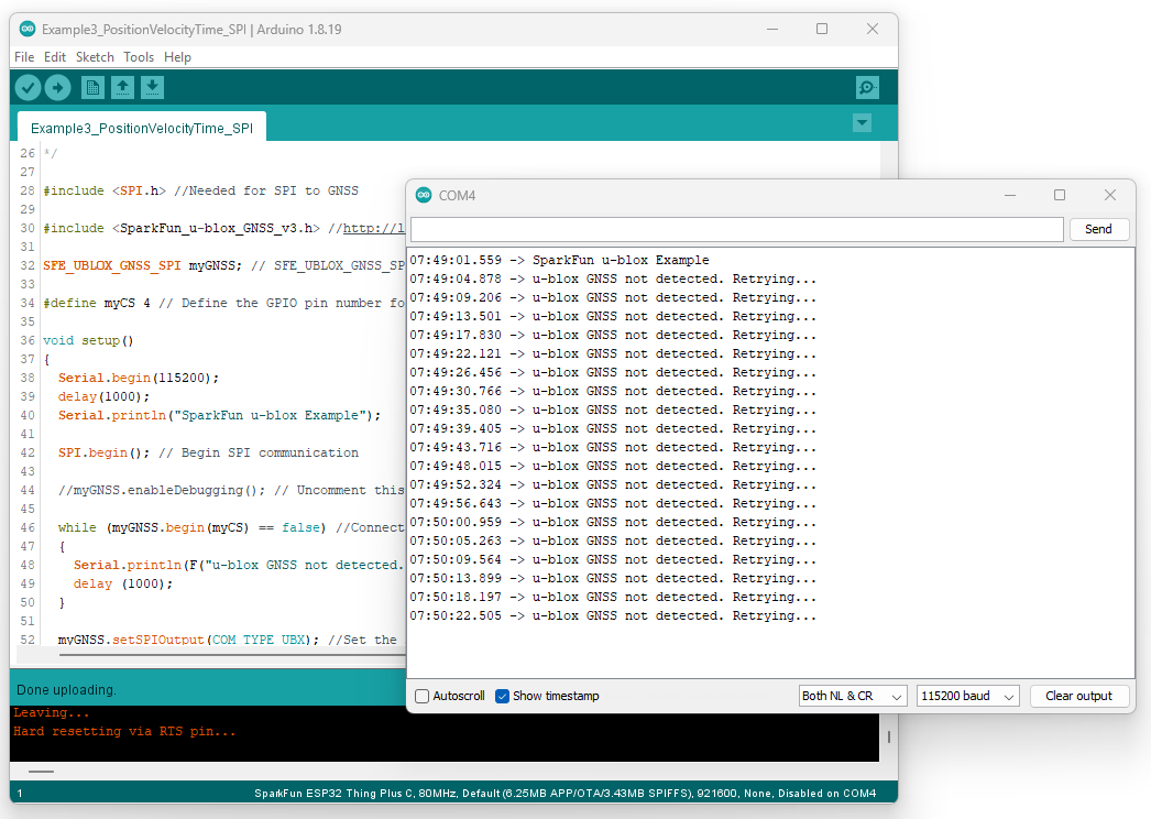

Testing here today, using an old ZED-F9P board with no back-up battery, and the Thing Plus C:
I was using the board yesterday, using the I2C interface.
Today, I have soldered the DSEL jumper, and nothing else.
Running that example, it fails the first time:
I connect u-center to the GNSS over USB.
Looking at UBX-MON-COMMS, I can see that it is attempting to use UART1 even though the DSEL jumper is soldered. I click “Poll” a few times, the UART1 counts are increasing.
I use UBX-CFG-CFG to “Revert to default configuration”, clicking “send” to apply.
I left the ESP32 code example running while I did this and now:
In MON-COMMS, the UART1 counts are frozen and now the SPI counts are increasing:
