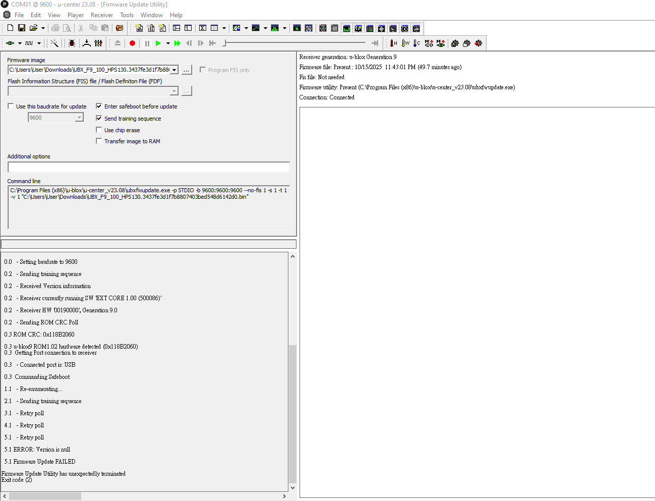

I tried to update the firmware to HPS 1.30 and HPS 1.40 which also failed and it has no message output now:
Would you provide any idea for updating it?
Thank you very much
I replug USB, it output message again, but update firmware always failed.
Try permutations and combinations of “Enter safeboot before update” and “Send training sequence”. Sometimes you need none, one or both…

Dear Paul,
Safeboot before update and send training sequence already ticked:
Do you have any idea?
He’s suggesting to un-tick one, then the other, then both….try all combinations of ticked/unticked and see if one works, one combination at a time
For USB (native) attached I’d not bother with Safe Boot or Training. USB should be baud rate agnostic.
If the firmware is invalid it should fail integrity checking and default to ROM operation.
I might try Chip Erase option.
But generally it’s a fight with settings/options until the upload works/takes.
Try 38400 baud, it should be default for UART1/UART2 in most circumstances. And 9600 when jumpered for SAFEBOOT
Dear all,
I sucessfully update the firmware by untick both and I got IMU output after firmware updated.
Thanks for all helping.
