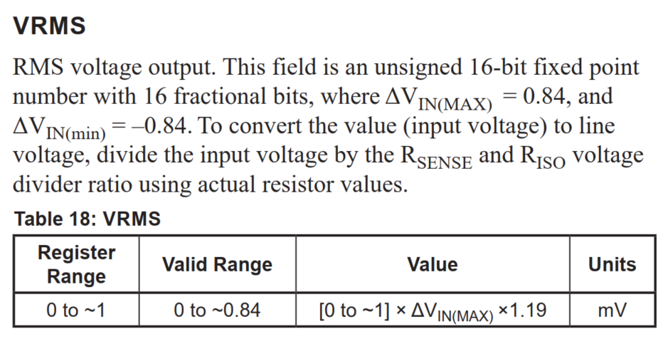

My problem is that the values read are not exactly correct. For example, it measures 194 VAC RMS, but the real value is 224VAC RMS; in current is similar, without load the value read is 0.088A and with a load of approximately 120W , the measured value is 0.680 A (it should be around 0.110A).

In the library I see a lot of magic numbers that I can’t work out where they come from, even thought they say what they are. For example, here I don’t understant where the 55000 value comes from:
volts /= 55000.0; //Convert from codes to the fraction of ADC Full Scale (16-bit)
volts *= 250; //Convert to mV (Differential Input Range is +/- 250mV)
volts /= 1000; //Convert to Volts
//Correct for the voltage divider: (RISO1 + RISO2 + RSENSE) / RSENSE
//Or:  (RISO1 + RISO2 + RISO3 + RISO4 + RSENSE) / RSENSE
float resistorMultiplier = (_dividerResistance + _senseResistance) / _senseResistance;
volts *= resistorMultiplier;
Also, the datasheet is very confusing in this matter as the calculation for the real value is very different and I can’t make heads or tails of this explanation:
I tried changing averaging samples, offsets, gains, and others but the values just went crazier than before.
I hope someone can help me understand what I’m doing wrong.

Hi Iván ( @Ivan_Gerber ),
The ACS37800 datasheet is really not great. I struggled with it while I was writing the Library and code examples.
The 55000 value comes from the 16-bit ADC (0 - 65535) scaled by the valid range of 0.84. The true value should be 55049. 1.19 is simply 1 / 0.84. I don’t think claude.ai got it right there…!
