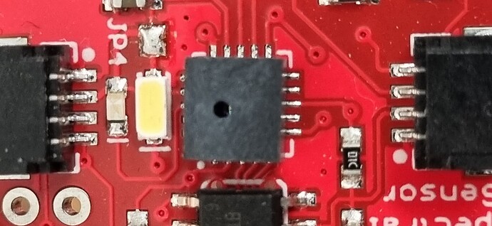

One of the AS7262 is displaying the blue power LED, flashing several times and then turning it off. To ensure it was not the I2C line or Power I swapped it out for the other sensor and it works fine leading me to beleive that the device itself is faulty.

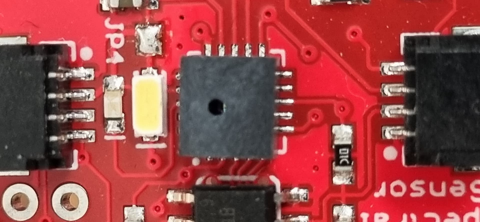

Upon examination it appears that the AS7262 chip itself is on a angle and was not placed correctly before being soldered. The other 3 units are perfectly square.
However saying that I am also not going to disscount other possibilities! so if anyone has any thoughts or ideas I would like to hear from them as this project is schduled for deployment down in Antartica mid September.
Cheers for any thoughts on this.
The legs look like they are making contact, but since the other one is working fine and this one isn’t I suspect it does have some kind of fault/defect
Was it purchased from us? If so head over to Return Policy - SparkFun Electronics (contact vendor if purchased elsewhere) and we’ll get ya squared away
Thanks, Yes. the replacement is on its way. I also placed an additional order for the :slight_smile:
