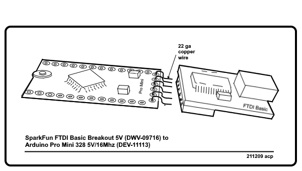

Hello TS Russell and the SparkFun forum,
Received the SparkFun FTDI Basic Breakout 5V and the Arduino Pro Mini 328 5V/16Mhz today. Did not realize the Micro USB connector was needed so the SparkFun Cerberus USB Cable - 6ft was ordered.
In the meantime working on a good way to connect the FTDI Breakout to the Pro Mini:
www.allenpitts.com/electronics/Mini_to_ … _x_450.gif
Just want to make sure the female headers on the bottom of the Pro Mini line up with the pads on FTDI Breakout line up as shown in the line drawing above.
Thanks.
Allen in Dallas
Yep - just ensure you don’t slip it on upside-down :wink:
