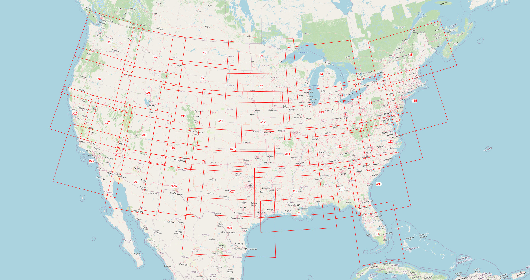

The plan I’m using for Continental US (48 States, not Hawaii or Alaska) is “PointPerfect L-band”, which I’ve subscribed to via the ThingStream portal. I added it as a “Location Thing” with a “Plan”, I did it a while ago, so the process may have changed, before that I tested it with keys I got from ArduSimple. The current key has validity Apr 30 - May 27 2025
I also have a “PointPerfect 100H” Plan, which provides the NTRIP NEAR-SPARTN, but used to be the MQTT method supported by uCenter Classic.
I read this when I set my equipment up.
The SparkFun tutorial on the settings on the NEO-D9S side is pretty solid.
This was my page, the GAD maps show the US coverage last time I decoded it.
Thank you!. Any info regarding CONUS and its coverage in EU would be a great help.
