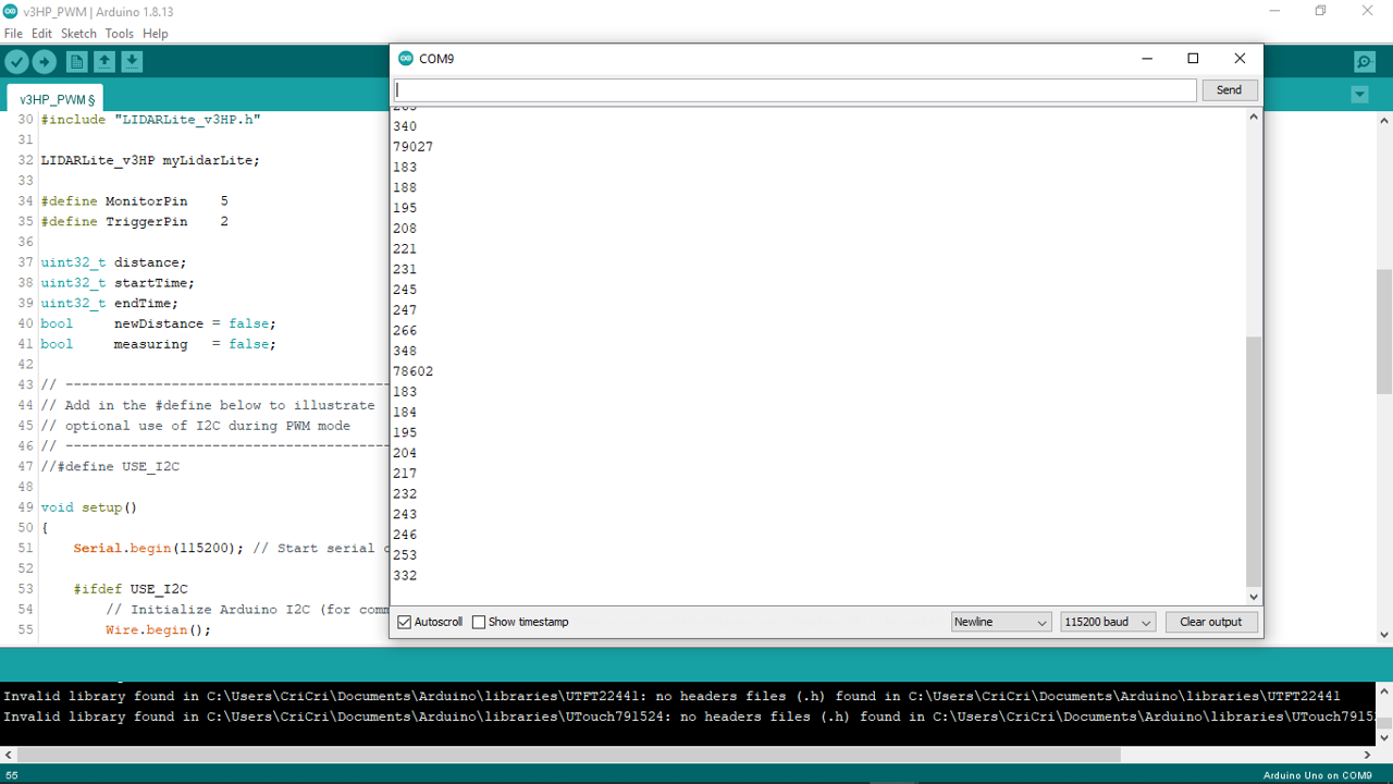

What I am getting is:
Also, I have tried using the PWM example code:

Here, I got interesting results as shown:
I don’t know what is going on.
Your help is highly appreciated

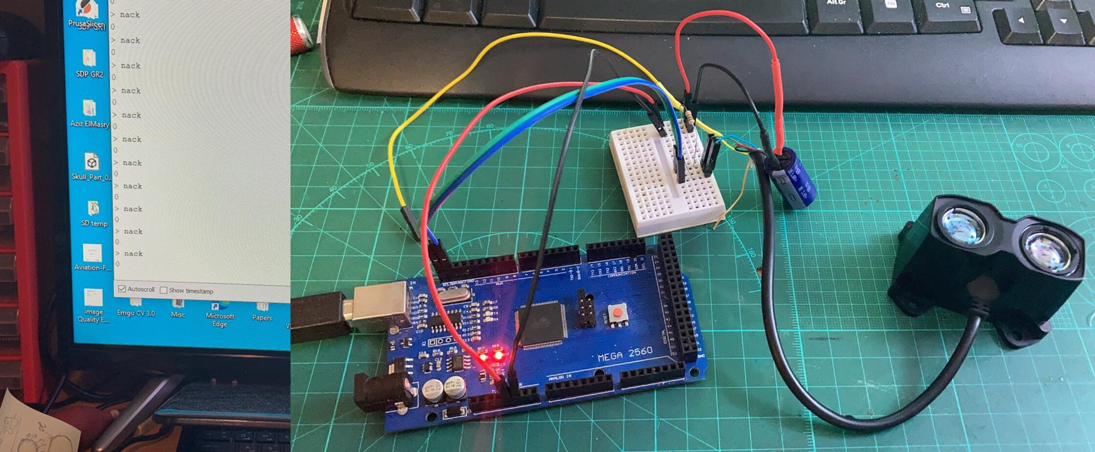

Did you also include the pull-up resistors on SDA and SCL line ?
No, I did not add the pull-up resistors. I thought it is optional!
You always need pull-up with I2C, but sometimes they are already on the board. I have to agree it is a little confusing the way is described in the operating manual and hookup guide. Anything between 4K7 to 10K will do. Both on SDA and SCL to 5V, unless you CPU board can handle only 3V3 on the pins, than they need to be to 3V3.
Thanks, Paul for responding,
I have added two pull-ups (5K each) but the results were the same “nack” as you can see in the attached image(lidar1.png).
I tried also using the pwm method, I was running the pwm example code that comes with the Lidar Lite v3HP library, and the results were very strange. Please have a look at the attached image Lidar2.png.
Now I am wondering about the firmware of the sensor itself!
I don’t know what to do!
can you share some pictures… this looks to me as basic connection / cabling.
Hi Paul,
I have prepared two sets of pictures. The first is for I2C wiring, and screen pics for code runs. The second is for the PWM wiring and also a screen pic for the code run and an excel graph for the results.
Here is the general wiring and the cap to the unit:
In this picture, you will see the wiring and the pull-ups
These are screenshots for running two example codes (v3HP_I2C and v3HP_MONITOR) that are in the Lidar_lite library:

For the PWM here are the pics. The first and second pics are self explanatory.
The screenshots for running the example code, and an excel chart for the results:
The lidar was pointing to the ceiling of my homeoffice, which is at 189cm. The numbers in the screen are strange but it contains the correct value in the second of third reading!
I would appreciate your help on that.
Wael

Thanks for your input and sorry for the delay in getting back to you, I was busy with other tasks.
Ok regarding your suggestions:
1- I have tried using another MCUs with ATmega328P and using mega2560, as seen in the pictures below, note: the run results screenshots are attached to the same picture.
The results in both cases were the same “nack”
2- I tried another breadboard as shown
3-I check my connections using the Avometer before connecting and everything is ok
4- The power supply is reading 5.0v
The header pins I am using are the long ones.
If you look at my try using the PWM example, the Lidar is working but there is something seriously wrong with. Look at the results, it is increasing exponentially, then it halts for a while(self reboot) then it starts giving values again. Look at the results I have obtained in an earlier trial:
Then, as Paul said, the only thing left is that the Lidar unit might be defective!
What do you think?
I think you should request a replacement for the LIdar unit
hi Paul,
I have submitted an RMA, is this the correct action?
