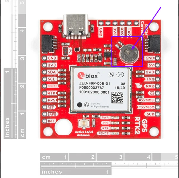

I am using :- SparkFun GPS-RTK2 Board - ZED-F9P (Qwiic) - SparkFun Electronics
I am observing that tiny backup battery is not working as I can’t lock GPS after quick power Cycle. If I want to replace this on baord is it any Coincell or it is rechargable battery coincell?
can anybody share link to battery used on this breakout board?

Hi @ha11otronix ,
Please be aware that the battery on the SparkFun GPS-RTK2 Board - ZED-F9P (Qwiic) is different to the battery on the SparkFun GPS-RTK-SMA Breakout - ZED-F9P (Qwiic). The GPS-RTK2 battery is a Seiko MS621FE-FL11E. The RTK-SMA battery is Seiko ML414H-IV01E. Please make sure you order the correct one.
Also, are you sure the battery needs replacing? Have you checked the cell voltage after leaving it powered and charging for a few hours? Perhaps you have not saved the F9P configuration - to Battery-Backed RAM (and/or Flash)? You need to ensure the configuration is saved before disconnecting the power.

Perhaps expand on this somewhat.
This is somewhat of a “cold start”, if the ZED is taking more than a minute to recover a GNSS fix, it’s indicative that the antenna is not working well, or poorly situated.
The battery is to maintain the RTC and BBR, so should hold time and location. I’m not sure it effectively holds the ephemeris.
For most of the other settings, pushing them into FLASH is typically how to ensure the receiver uses and retains them.
I have a question about the ZED-F9P USB-C (1568-15136-ND) board.
I have bought dozens of them via DigiKey over the past year and never had a problem configuring these boards with the ublox u-center application.
Up until today. When I finish the configuration, save it, and close the application but leave the power on, and test with an external antenna connected, it works fine. However, as soon as I remove the power and connect an external power supply, it stops working.
When I reconnect it to the u-center application and look at the configuration, all settings are back to the default settings.
Now, there is a battery on the board. Could it be that it is empty or defective from the factory?
And the question is, can I replace it? And if the answer is yes, what is the best place to order it?
If I search for Seiko ML414H-IV01E
do I see a different model?

Sorry the RTC is not working for you.
1568-15136-ND = GPS-15136
The battery you are looking for is the 728-1057-ND.
