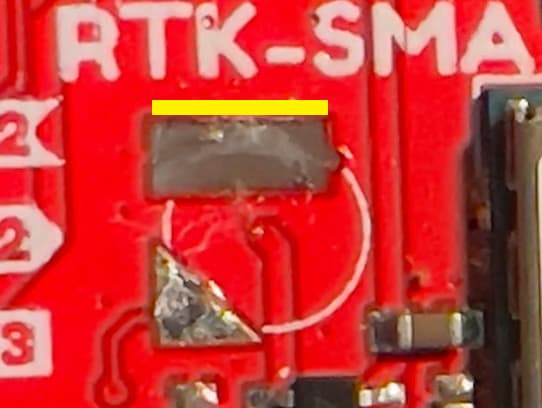

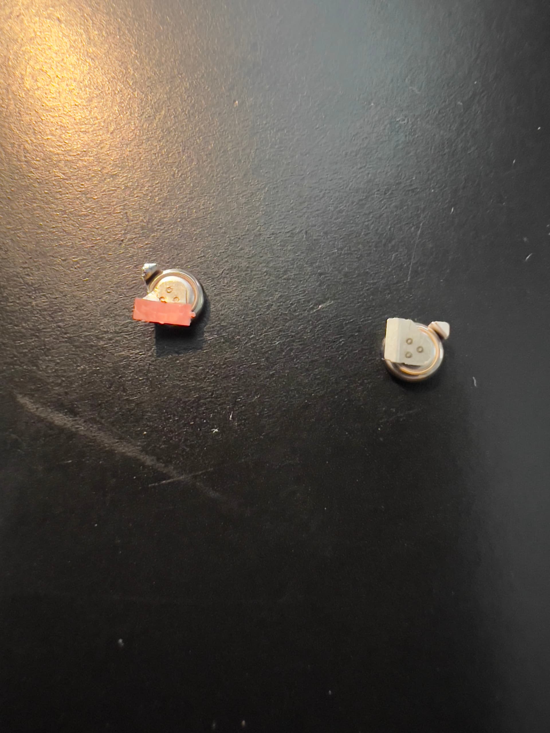

I finally got the nerve up to replace the battery. First I checked the current battery (1.5v), then the replacement battery from DigiKey (package says 3V, I measured 2.46v). Not sure if I should have had a higher reading, but I forged ahead.
Did as you suggested, gently heated the right side, lifted with an X-acto, it popped up. Whew!
Moved to the left side, repeated the process, and it too lifted up & the battery was loose.
One problem - the left side brought up the mounting surface from the PCB!
Dang it!! My Weller WE1010 iron was at 696F (what I solder at). And I have really been practicing my solder skills so I feel my technique was good. Minimal tip contact time.
I fired up the rover, the RTK-SMA still seems to be working ok, but I’m back to cold starts.
Any suggestions Paul? I’m not sure I even see the PCB trace for the + side of the battery.
Posting here to help the next soul who travels this road. :frowning:

Hi Doug (@doug_f ),
Oh dear… It happens… I’ve been reworking boards for 40 years and I still occasionally lift pads off the board like this…
But you should be able to recover this without too much difficulty. You’ve lifted the rectangular GND pad off the board. You should be able to scrape away the red solder resist from the edge of the surrounding ground plane. Use the tip of a scalpel blade at a shallow angle; working left-right with gentle strokes. You will start to shave off thin layers of resist; keep going until you reveal copper. Tin that with solder, and then solder the very edge of the battery 0V tag to it. Finish by soldering the triangular +ve tag.
Good luck! All the best,

Success … that worked! Hot starts again. Thanks Paul!

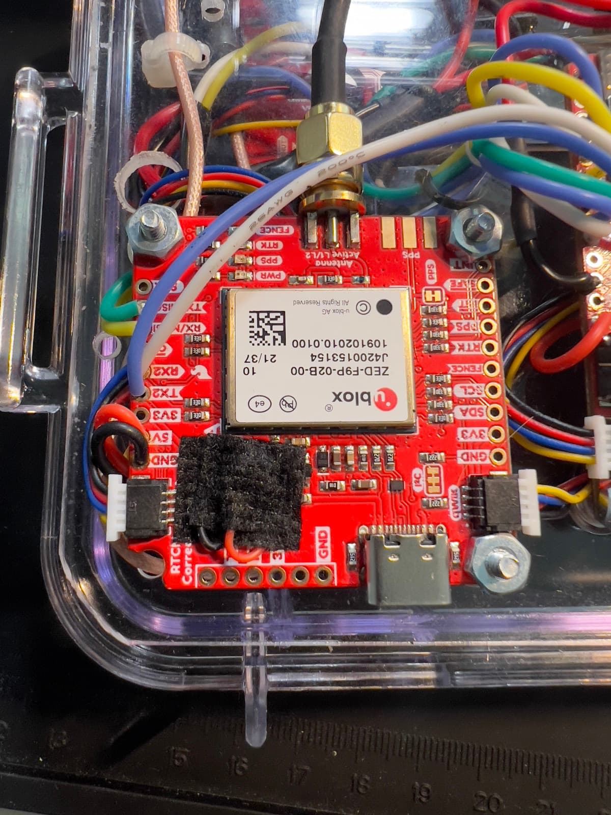

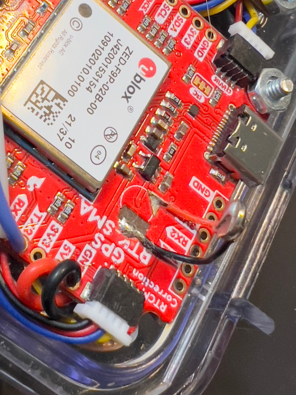

Rather than solder the new battery to the board, I used two short runs of 30 AWG soldered to the battery (photo before defluxing), then black cloth tape to secure.
Thanks for the update Doug - glad you’re back in action,
Two layers of tape: one under, one over. Perfect. We’ll make an engineer of you yet! :wink:
