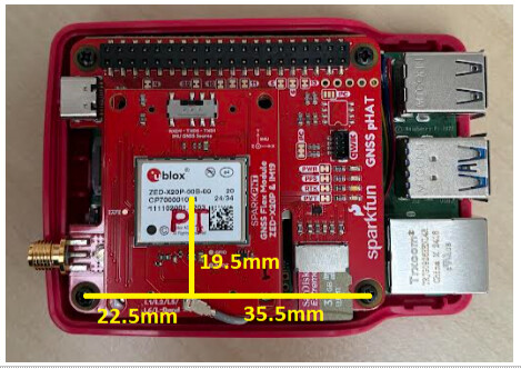

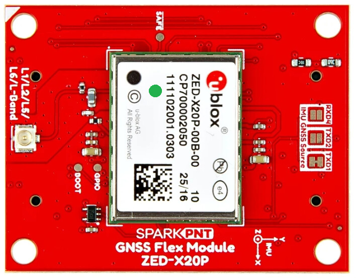

The X20P and IM19 module packages are centred on the centre of the Flex module. On the pHAT, the position relative to the mounting screw holes is:
Important note: The IM19 IMU origin is not centred on the centre of the module. Using IMU Coordinates, it is offset by -5.72mm in X, and -2.72mm in Y. The green dot is the IMU origin:

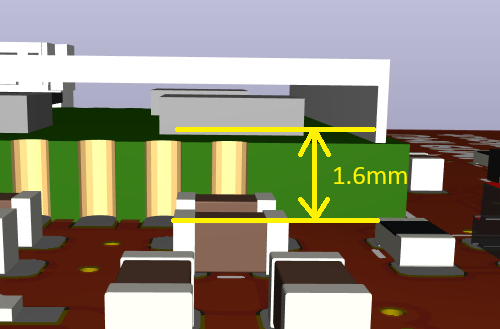

The IM19 Z origin is 1.6mm from the back surface of the Flex Module PCB:
In IMU Coordinates, the top surface of the Flex Module PCB is offset by +3.2mm in Z. 1.6mm for the PCB thickness plus the 1.6mm internal to the IM19.

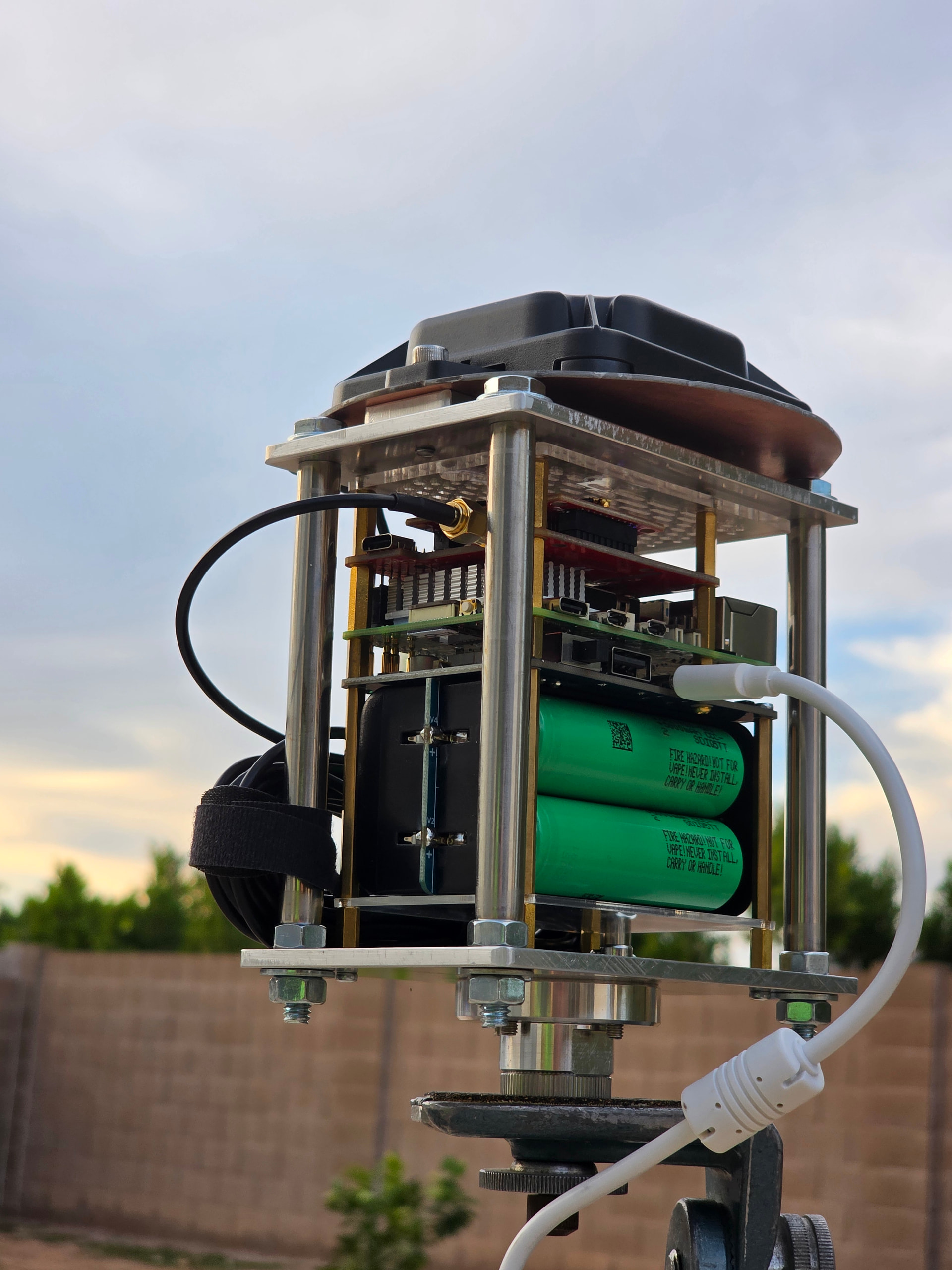

Thanks for all the help. With the information you provided here, and with the working notes you sent privately, I am getting some results that look promising. Using two instances of PyGPSClient is very helpful, and pretty much essential.
This is my rover on a tripod:
The flange on the bottom is for a diamond saw or angle grinder that was easy to modify to attach a the cage I fabricated from 4 mm aluminum. The posts are just 1/4" bolts passing through some stainless steel tubing I salvaged from a discarded walkway light. The stack inside the cage is centered, and composed of a Waveshare UPS (E) and the other components I listed in the first comment.
I may have a sign error in my AT+LEVER_ARM2 setting. So far I’ve been testing with the rover mounted on a tripod that is significantly shorter than the 2 m pole I used for the AT+CLUB_VECTOR setting. The 2.1474 m includes the pole, 139.88 mm from base of flange to the base of the antenna reference point, and 7.53 mm to the mean APC offset from the ARP.
AT+CLUB_VECTOR=0,0,2.14741
AT+LEVER_ARM2=0.002372,0.000772,0.02929
AT+INSTALL_ANGLE=0,180,0
I used available CAD files to assemble a drawing in FreeCAD to determine the offsets for AT+LEVER_ARM2. The red lock is in this drawing is the axial center of the pole, component stack, and antenna. In the reference frame centered at the center of the ublox ZED, and aligned with the printed “IMU axes”, the axial center is at X=15 mm, Y=5 mm. I added the documented offsets from chip center to IMU origin to get the values LEVER_ARM2 X and Y. The Z value is based on the distance from the top of the Flex Module to the APC of 29.29 mm. (Looks like I forgot to add 3.2 mm to compensate for PC board and IMU thicknesses).
I’m not sure if I interpreted/specified the LEVER_ARM2 and INSTALL_ANGLE values correctly. I would appreciate feedback on how I set them.
Also, I never thought much about Roll, Pitch, and Yaw in this context. I guess the rover pole has a forward, left, and up directions. Up makes sense, but forward and left seem arbitrary. How do I use those values to check my setup?

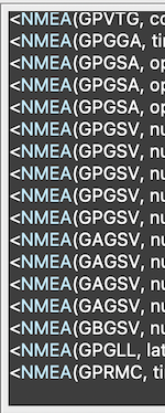

I updated my IMU settings, but I’m not seeing any data in the IMU Monitor View of PyGPSClient. I see GPFMI messages in the Console which make sense, but I don’t know why they’re not showing up in the Monitor View. I’ll look at that later.

Regarding the IMU Monitor View, there’s a trick in that you need to have NMEA ticked in “Protocols Shown”, and TTY unticked. If NMEA is unticked - or you have TTY ticked - you’ll see “No data available”.

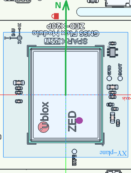

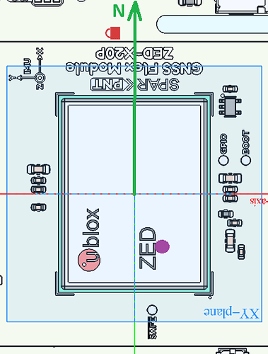

The IMU X,Y,Z axes are defined using the right hand coordinate system. For the body frame, they use Front-Right-Down. The simplest case is where X points Front, Y Right and Z Down. When X points North (in the North-East-Down reference frame), the Yaw angle is zero.
If you orient the pHAT so that X points North:
The IMU origin is roughly where I’ve place the magenta dot.
Feyman say that INSTALL_ANGLE should be sent first, then LEVER_ARM2.
The IMU faces down - rotated around X - so we should send:
AT+INSTALL_ANGLE=180,0,0
Then we should set LEVER_ARM2 using the default IMU coordinate system. Feyman say that with the Antenna to IMU offset as drawn, the X,Y and Z offsets are all positive. I had misunderstood this previously…
Working from the pixel scale of your screenshot and the position of the red lock symbol, I believe LEVER_ARM2 should be:
AT+LEVER_ARM2=0.0237,0.0050,0.0325
I’m expecting another update from Feyman on Monday. I’ve sent them five STEP files containing different antenna-IMU offsets and orientations, and have asked them to provide LEVER_ARM2 plus INSTALL_ANGLE for all five. I’ll post an update when I get their reply.
More later - all the best,

I need to fix my AT+LEVER_ARM2=X,Y,Z setting. My X and Y values were off by an order of magnitude. I will go back to my FreeCAD model to see if I can insert the dimensions into the drawing.
The ublox ANN-MB2 Data Sheet states that antenna “North” points toward the antenna connector. Because of the spacing of the antenna mounting holes, I needed to rotate the antenna in order to bolt it to the top of the cage I fabricated. In my case, North is aligned with the IMU Y axis so I have an additional 90 degree rotation around Z. Based on the alignment you show, I agree with your setting.
It appears that Feyman is applying the install angle rotations in X, Y, Z order. The conventional order is Z-Y-X. If the conventional order were used, the Z rotation would need to be 270 (or -90) in my case. I could be wrong here, but that’s what I suspect is happening.

For the Body Frame: The Red arrow points Front. The Green Arow points Right. The Blue Arrow points Down.
For the Reference Frame: The Body Front is pointing North. The Red Arrow points North. Green points East. Blue points Down.
In Configuration_1_FRD: The IM19 faces Up. IM19 X axis points Front / North. The antenna is 140mm above the IM19.
In Configuration_2_FRD: The IM19 is rotated around its Z axis. The X axis now points Right / East.
In Configuration_3_FRD: The IM19 is rotated around its X axis. The IM19 now faces Down. The X axis still points Right / East.
In Configuration_4_FRD: The IM19 is moved Left (West) by 75mm The X axis still points Right / East.
In Configuration_5_FRD: The IM19 is moved Back (South) by 50mm. The X axis still points Right / East.
Configuration 5 matches your pHAT assembly, when the IM19 Y axis points North.
I agree that your settings should be:
AT+INSTALL_ANGLE=180,0,90
or thereabouts…!
Very best wishes,
Tagging @semuadmin so he can follow the discussion
Sorry - one more thing:
Feyman confirmed that the reported Yaw should be the same for all five configurations.
Thanks @PaulZC ,
The drawings were very helpful.
I tagged your reply as the Solution, but the complete solution involves most of your posts.
Feyman documentation was not very clear. I was looking at “IM19 User Manual V 1.1” and “IM19 User Manual V 1.3.7”. It was not clear whether the IM19 origin was the corner of the package or the position of the MEMS unit within the package. I also noticed that the package size in the older manual was 16.4 x 14.8, but 18.4 x 14.8 in the later manual.
Your attached drawings verify that the IM19 “origin” is the location of the MEMS, which is offset from the package center at (-5.72,-2.72) or (-5.7,-2.7) as shown in your drawings (Section 2.4 of V 1.3.7 IM19 User Manual shows more precision).
I did discover something curious. I entered the following commands:
AT+LEVER_ARM2=0.02372,0.00722,0.03249
When the second command was entered, the IM19 sent the response:
Lever Arm : 8.886e-03, 1.793e-02,-3.249e-02
Apparently there is an additional origin offset that is applied internally by the IM19 firmware. I don’t know why 7.22 mm was changed to 8.886 mm, nor why 23.72 mm was changed to 17.93 mm. I will just accept it as necessary :wink:
Now that my question has been resolved, I am ready to move on to the next steps. I need to add some kind of onboard feedback. So far I have been testing with PyGPSClient over VNC. I need a way to monitor the IM19 status so I can go through the initialization steps and keep track of Ready status.
Thanks again!
I had some success with the IM19 a week or so ago, but now it’s not working. I just noticed that the output from UART1 of the ZED-X20P is showing “GN” messages instead of “GP” messages.
I’m running PyGPSClient on both my base and rover and using NTRIP over my LAN’s WiFi.
I updated PyGPSClient a few days ago, and I’ve run into a couple of bugs, so I’m not sure if that is related.
Any ideas where I should start?
Hi steve.talent - what specific issues are you having with PyGPSClient in relation to this procedure? I’m not aware of any significant bugs with the latest 1.5.20.
FYI re. “GP” vs “GN” - this may be a “CFG-NMEA-MAINTALKERID” setting issue. “GN” is the traditional ‘talker’ for GNSS in general; “GP” refers specifically to the USA’s GPS constellation, as opposed to “GA” (Galileo), “GL” (GLONASS), etc. By default, the X20P will output “GN” but you can set CFG-NMEA-MAINTALKERID to 1 to force it to use “GP” instead:
(This provision is a throwback to the original NMEA 2.n protocol which pre-dated the current multiplicity of GNSS constellations)
Note: this only applies to the X20P - the IM19 should only ever output GPFMI, e.g.
Hi Steve (@steve.talent ),
I’d recommend checking your NTRIP connection, and making sure that your Rover is in RTK Fix. The tilt compensation won’t work without RTK Fix.
I don’t recall needing to change the Talker ID. I believe the IM19 is agnostic on GN vs GP.
That was my expectation as well - but just wanted to mention it as a possibility.
