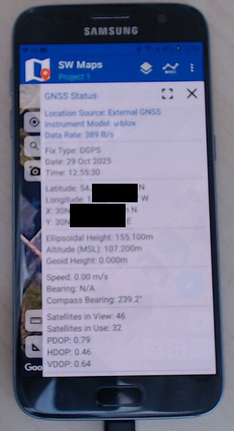

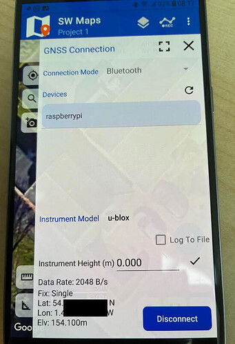

I opened SW Maps on the phone, selected Bluetooth, raspberrypi and u-blox. I hit Connect and it was able to connect to the Pi.

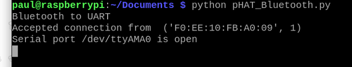

In the first Pi terminal window, I ran sudo socat /dev/rfcomm0 /dev/ttyAMA0 and left it running. (Photo below)

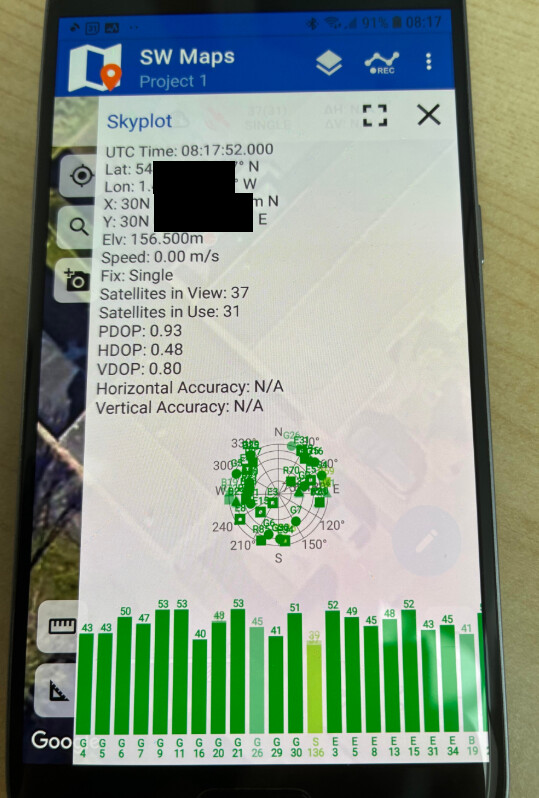

SW Maps is getting data and displaying my location. (Photo below)
It’s a bit hit and miss. If I disconnect, I can’t connect again - unless I reboot the Pi… Not ideal.
So, this is the bones of a solution, but it needs a load more work…!
Hi Steve (@steve.talent ),
Hah! The following crappy Python code works surprising well!
It’s one-way. It only forwards traffic from UART to the socket.
But it seems fairly robust.
And you don’t need the sudo rfcomm watch or the sudo socat
I hope it comes in useful,
import bluetooth # sudo apt-get install python3-bluetooth
import serial
import sys
server_socket = None
client_socket = None
ser = None
print("Bluetooth to UART")
try:
    server_socket=bluetooth.BluetoothSocket( bluetooth.RFCOMM )
    port = 1
    server_socket.bind(("",port))
    server_socket.listen(1)
    client_socket,address = server_socket.accept()
    print("Accepted connection from ",address)
    serialPort = '/dev/ttyAMA0'
    ser = serial.Serial(serialPort, 38400)
    if ser.isOpen():
        print("Serial port",serialPort,"is open")
    while True:
        uartrx = ser.read(1024)
        client_socket.send(uartrx)
except:
    if client_socket:
        client_socket.close()
    if server_socket:
        server_socket.close()
    if ser:
        ser.close()
    print("Bye!")
    sys.exit(0)

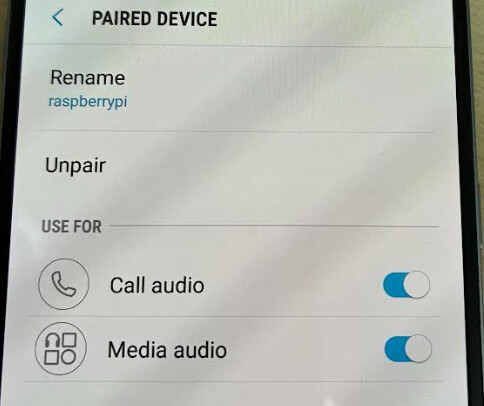

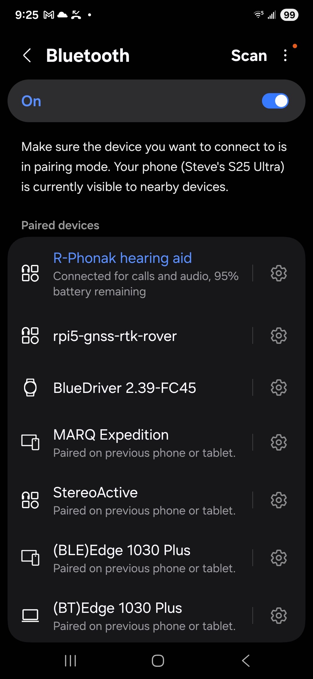

I believe my issue is more related to establishing the Bluetooth connection. I think it could be related to the Bluetooth configuration, and how Device and Service classes are being used when the devices are being connected. I need to study the documentation in more depth to better understand the messages I see from bluetoothctl that I posted in my previous reply. For example, sep13 refers to a Stream EndPoint (SEP), a specific D-Bus object created by the BlueZ stack to represent a media stream. In may be related to the Advanced Audio Distribution Profile (A2DP) used by audio services on the Pi.
When I look at Bluetooth connections on my Android device, it shows an icon indicating Audio/Video device.
I think there should be a different icon displayed for rpi5-gnss-rtk-rover in this image. What icon do you see when you pair the External GNSS device?
I think I’m seeing the same thing:
It doesn’t seem to matter. Serial Port Profile seems to be working fine with the sample code:

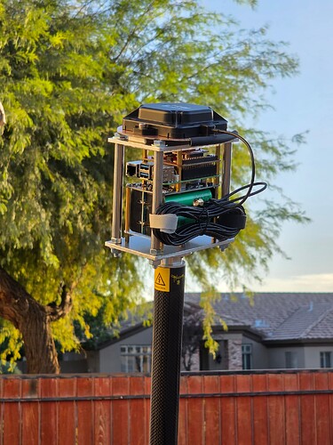

I managed to corrupt my system so I went back to the beginning with a fresh SD image. I also decided to finish the mechanical fabrication of my system for a rover pole. The head unit weighs 1.34 kg, and most of that is the batteries.
After being misdirected a few times by Google Gemini or ChatGPT, I decided I should take my time, study the docs, and document my progress from beginning steps to working system. It may be a few more days until I have something working. I want to understand what I’m doing in more depth and learn more in general about working with Bluetooth.

@PaulZC – Your code is working for me. Thanks!
