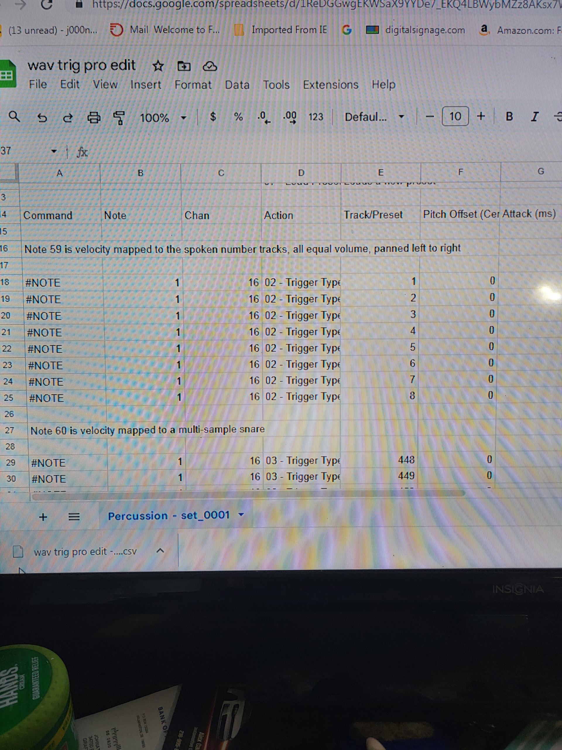

I took the example percussion download file and edited in Google sheets.Like you said, but no changes I make make any difference wave pro responds the same way.
I don’t know why it just poked those pictures in this middle of the message.
So if I made all those changes that you can see in the pictures there, something should have changed. Still just 0001 Number.
I even tried swapping out a wave file to the 0001 slot , and it wouldn’t even play So if I made all those changes that you can see in the pictures there, something should have changed. I even tried swapping out a wave file to the 0001 slot, and it wouldn’t even .play I’m pretty sure I had it named right. How long of a wave can it handle. It was a song saved as wave. When I put the old wave 0001Number that one played again.

For some reason , no matter what I do I cannot get trigger 1to play any wave other than wave 0001. Even when I put a different wave number in the slot for track.
Man , i’m not sure if this sent the message or not. But I’ll try again if you’re allowed to send pictures in message.
This is the command line I changed to try to get pin 1 to to play note one an activate preset four sixty four , which is a crash. If there is something incorrect , please tell me.
I Don’t know what else to do.
Interpreting what you’re trying to accomplish from screenshots is difficult. Please consider what I asked three posts ago: Tell us precisely what you want to happen.
One thing I do see… the Min/Max Velocity Gain fields in the preset are in units of dB, as the spreadsheet comments indicate. 0dB is full volume - you can’t go any higher than that. You have a value of 17, which is not valid.
I also suggested that you hook up the serial port to the Arduino Serial Monitor so you can get some feedback when loading your new preset. It’s likely that your preset is failing to load properly because of an erroneous entry (such as above) and when loading a preset via the Serial Monitor, it will tell you that the preset didn’t load and what line the error is on.

Okay I want pin trigger one to play channel one. Preset four sixty four. At the loudest volume.
I will change the velocity gain from seventeen to 0
I think you may be mixing up terms. By “Preset four sixty four”, do you mean track 464? That would be the track with a filename such as, “0464_mysound.wav”. By “play channel one”, do you mean you want the track to only play on the left output channel? Is the file mono or stereo?
What do you want to happen if the trigger is activated again while the track is already playing? do you want it to stop the previous instance, or play another copy (polyphonic)?
Sorry to be so picky, but I can’t help unless you can be clear about what you want to have happen.
Sorry , I meant to say track four sixty four. Which is a wave file. I want pin 1to play left and right out. So panning is at 64. Pin one is tied to channel 1 but I had the channel setting at sixteen , because that’s supposed to be omni. Is pin one also considered note one? Should I not use a note number if i’m using the pin?
I’m using the downloaded example.You guys gave me with the samples on it. The percussion download. You can use trigger three action.
I m mostly interested in seeing you tell me how to make trigger pin one play track four sixty four.
Eventually , I will want the same thing to play a different PRESET no matter what number. I’m just trying to make this thing function.
I understand most of the parameters I’m just not getting any Results. Velocity gain is the only one that’s confusing to me. It seems I would have to have a negative 127 for min and 0 for maximum volume to do some things I wanna do. But I won’t worry about that for now.I just wanna see pin one play a different wave track OTHER THAN 1. I just Got off work and I haven’t had time to mess with it yet today.
That last screenshot I sent you should do it except for the volume gain being seventeen.
