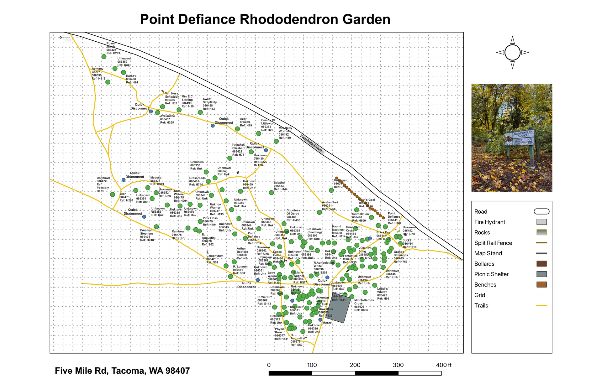

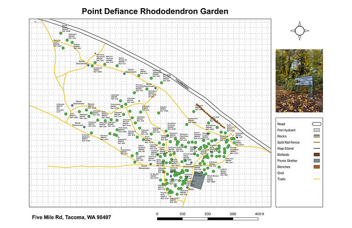

Thanks for the suggestion. It was a pretty steep learning curve, but I’ve been able to figure out SW Maps and QGIS enough that I’m going to be able to produce the kind of map I envisioned. I’m certainly only scratching the surface with QGIS, and the user interface with QGIS is quirky and not always intuitive, but I can’t complain too much since both SW Maps and QGIS are free.
This is one version of the map. I’ve set up 5 in QGIS, each showing different sets of features. I still have about half the garden to finish measuring.
