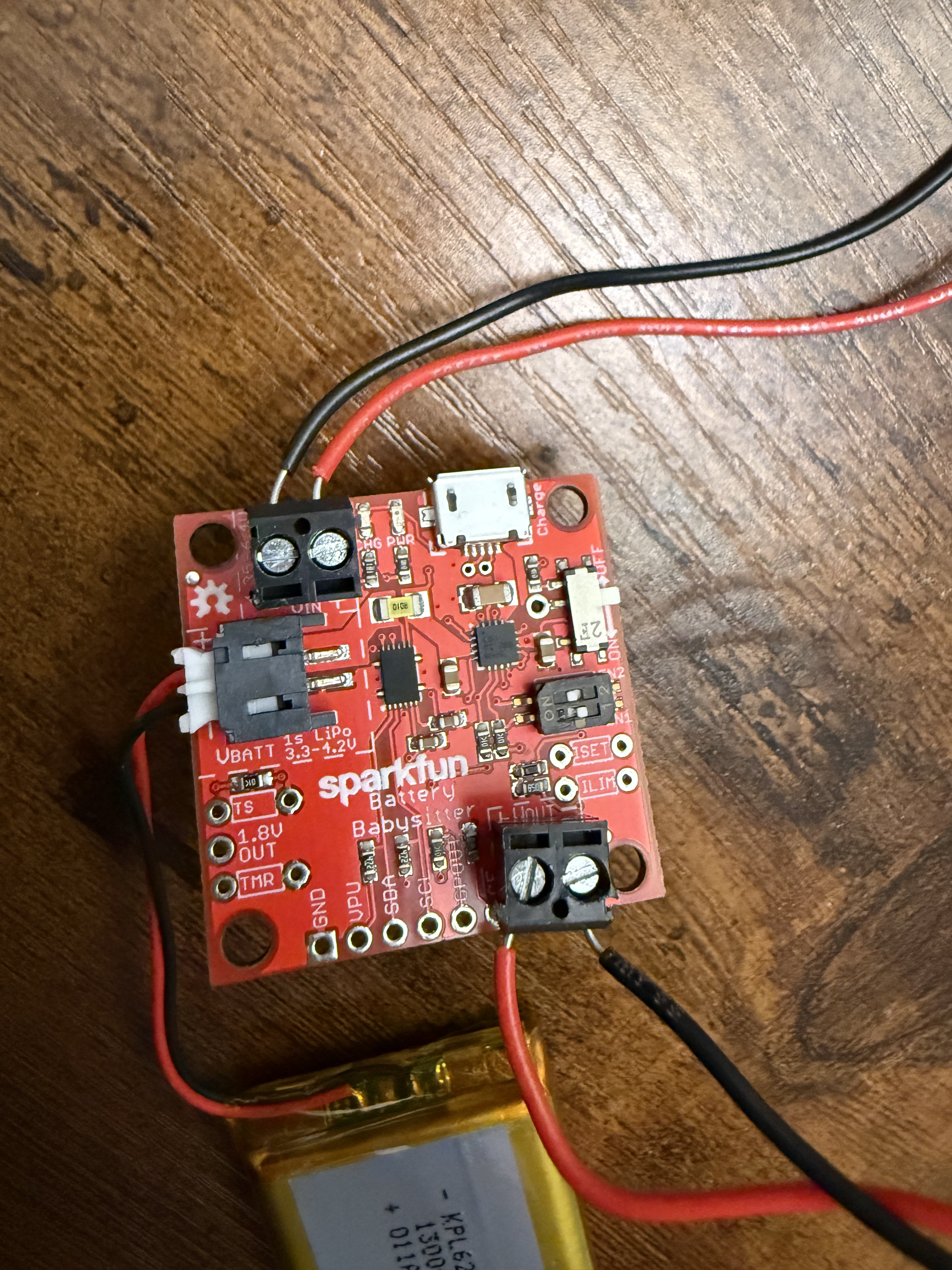

              I’m not sure what’s wrong with this circuit here. The ESP32 doesn’t turn on when the Babysitter is turned on. However, if I plug in the ESP32 via USB, the Buck LED turns on for some reason.
Solar Moisture Sensor Drawing.pdf (59.1 KB)
              Another update - there is no voltage coming out of the babysitter with the below configuration. The battery is fully charged.
              Flip that switch on the right side of your most recent photo to ON

              It’s still not outputting anything despite being on.
              Gotcha. You’re testing the lower leads, right? (VOUT)
I’m wondering if your terminal block is struggling to make a good connection (it looks a bit crooked and might have a manufacturing defect)

              The solder connections looked okay but I’m trying to remove the current terminal and replace it.
              I tried a new Babysitter which is outputting about 3V, however the buck boost is only outputting 0.7V. I am using a 680 Ohm resistor and based off my calculation, I thought that would output 8.7V.
Edit: Does it need to be powered/grounded with the Vin and GND pin?
Edit 2: When set to 3V and 5V it works but not when its set to the custom setting
              It turns out I used the wrong resistor with the Buck Boost. The equation in the hookup guide solves for resistance in the thousands which I did not see.
