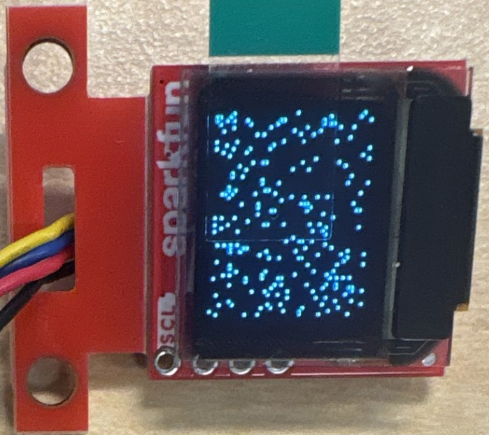

Micro OLED displaying garbled pixels when trying to get example to run
I’m using a ESP32 Thing Plus-S3 and a Qwiic connector to get the Micro OLED breakout working. However, when I tried running the example sketch, the following displays.
I thought at first it was the random pixel function but after realizing nothing else was happening I commented it out and nothing changed. Then I stripped down the example code to just one example and it still shows the same; here’s the code for that.

The random garbled pattern isn’t constant, sometimes it changes when I upload different code to the board.
Here’s what else I tried so far
  • Different Qwiic Cables (only have two, so maybe two are busted)
  • Did an I2C scan and got the address as 0x3D
  • Different USB cables, different ports
  • Basic sketch to just say hello, didn’t work
This is the first time I’m using an ESP32 and the Qwiic stuff so maybe there’s something simple I’m overlooking but I’ll appreciate any help.

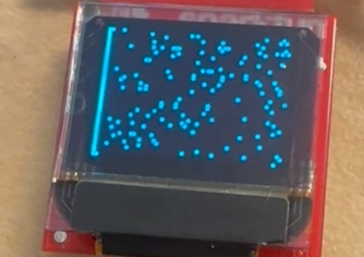

and the OLED looks like this;
Looks like a defective unit - Was it purchased from us? If so head over to Return Policy - SparkFun Electronics (contact vendor if purchased elsewhere) and we’ll get ya squared away

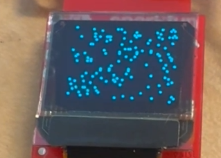

Two different OLED displays are working the same way on two different ESP32 boards. I switched both OLEDs to an Uno board and they both work just fine.
Ah - in that case it’s likely something going on with the i2c bus. Can you try a different i2c Hz in your code?
I will try that. The ESP 32 does work with other i2c devices. FYI

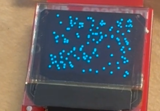

I did change the i2c clock from 400kHz back to 100kHz and then to 200kHz. No change.
I do have an Adafruit 9-DOF Absolute Orientation IMU Fusion Breakout that does work with the ESP32.
I do have a functioning sketch that runs both the 9-DOF board and the OLED from the Uno.
The sketch works on the ESP32, the OLED just does not display correctly with the ESP32.

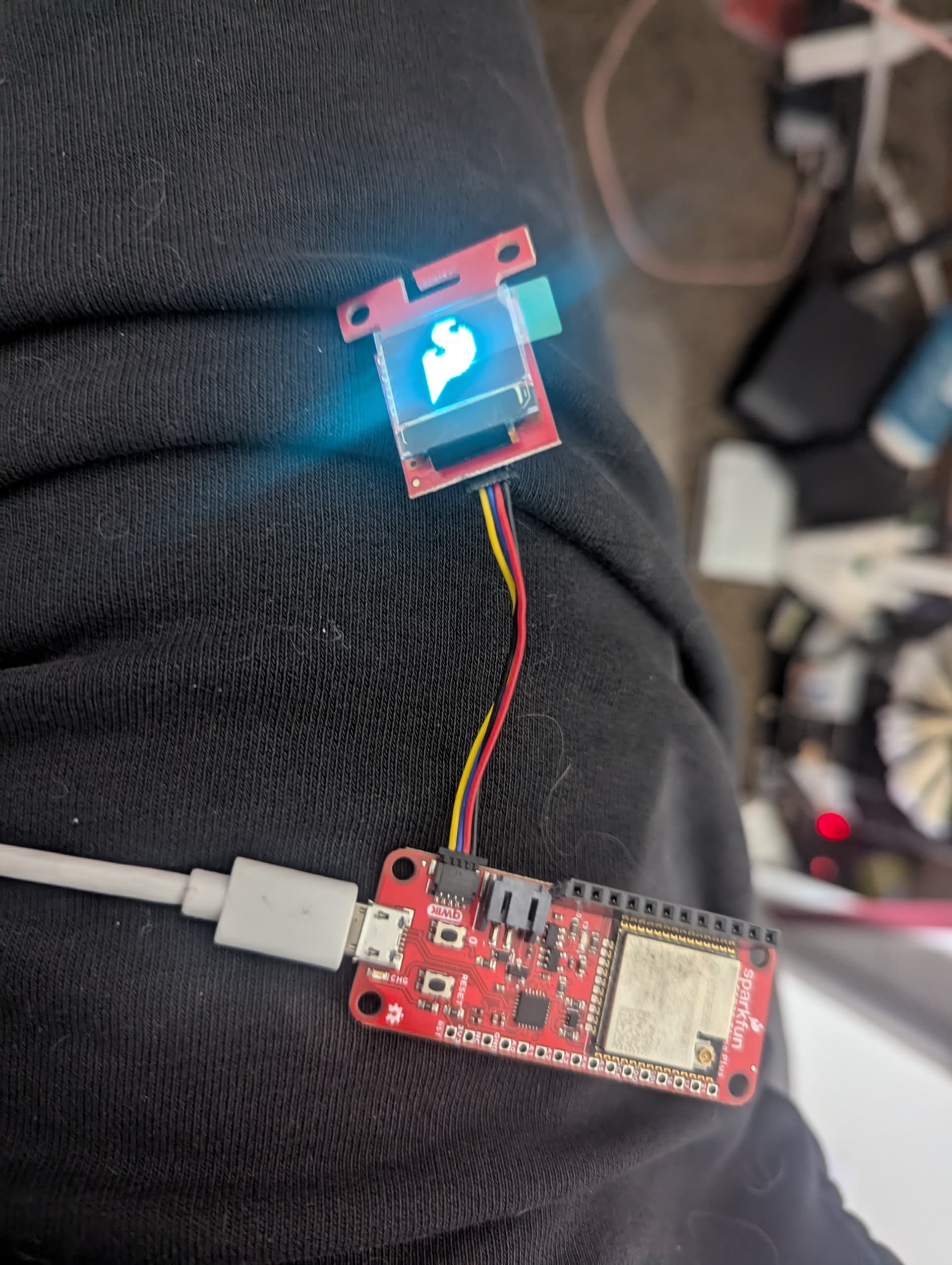

I got the OLED working with a Thing plus Artimis but not the Adafruit 9-DoF Accel+Gyro+Mag (BNO055).

The board I am using is the SparkFun ESP32 Thing Plus.
I tried copying the code below but it has multiple Compilation errors. I looks very similar to the
Examples from Custom Libraries/SparkFun Micro OLED Breakout/Example3_MultiDemo
I am getting some response with this Demo, see enclosed Pictures (I tried to send a video but it was to large).
(attachments)
It worked fine on my regular Thing Plus - still haven’t re-found the S3 :-/
I can have my boss try an S3 as well and see how that goes (I’m also going to test with the usb-c thing plus because I have one of those too)
UPDATE
The usb-c version is garbled like your unit, I am testing/fiddling with code now…
Ok, I got the usb-c one to work as well simply by updating the “Sparkfun qwiic OLED library” to 1.0.13 and running the examples from ‘Sparkfun Qwiic OLED graphics library’
