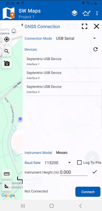

A partial update for you:
I’m experimenting with an old Samsung Galaxy Note 8. I’m using a USB-C → USB3 OTG adapter plus a regular USB2 cable to connect the phone to the mosaic-X5 Breakout USB connector. The phone is powering the mosaic successfully, and the mosaic has a fix. The ā€œSerial USB Terminalā€ App is able to detect and open the USB1 and USB2 virtual COM ports. But, more importantly, SW Maps is also able to connect and - to my delight - is Mosaic-aware, can configure a stream of NMEA to the same COM port and display my position:

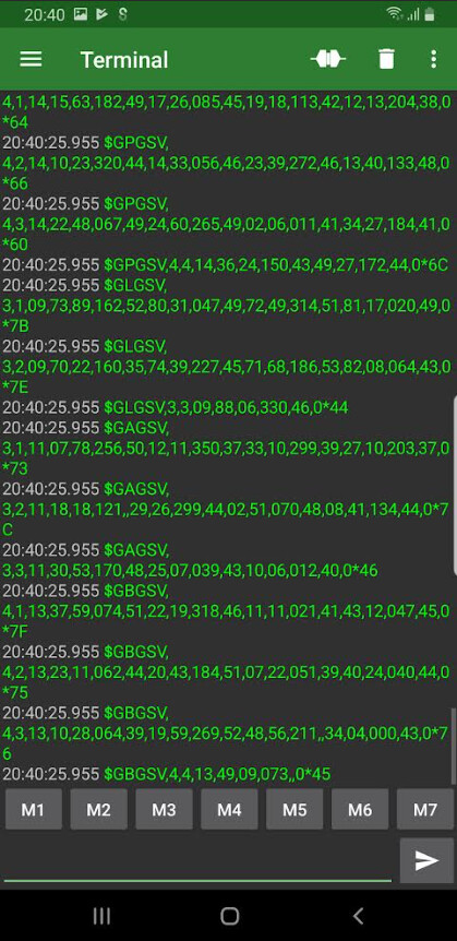

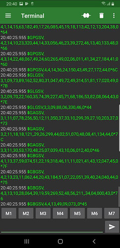

Closing SW Maps and returning to Serial USB Terminal, there is now a stream of NMEA on USB1:
I haven’t yet found a way to access the Ethernet-over-USB and the X5’s web page, but I’m hopeful because SW Maps is detecting the interface. It is Interface 1 in the above screenshot. (Interface 3 is the USB1 virtual COM port; Interface 5 is USB2). Serial USB Terminal detects them as ā€œSerial device - CDC Port 1 … 3ā€; CDC 1 is the Ethernet-over-USB port.
