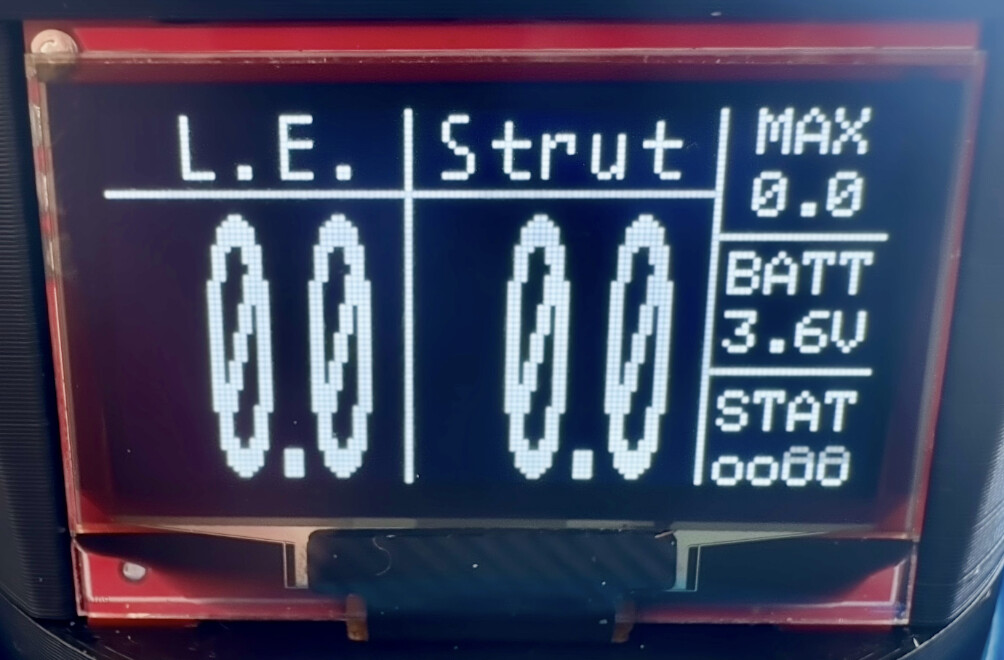

I have been having some good fun using the Open Log Artemis to develop a measurement tool kit.
I was honestly a little bit surprised to learn that there was no native support for any of the qwiic displays. Rather than accepting defeat, I bought an OLED and decided to spend some time learning how to add a Sparkfun qwiic OLED as a read out for 2 of the data fields I was logging (in this case; two pressure sensors and then also the battery voltage, because I had available space).
2 Questions:
  1. I am NOT a software engineer, and I am pretty sure I would be burned at the stake for how I implemented this. What should have been the right way to add this to the current OLA software architecture? (ill share how I did it later, but wanted to ask open ended first)
  • where should the data be “scraped from” in the code base? is there somepleace easy where the values are freely available to just send to a display update routine?
  • where is the safest place to add in/call a display update routine that wont interfere with the primary function of data logging
  1. If I took a stab at doing this right, is this a feature that would be welcome in the code base? I think I would accomplish this by:
  • Adding detection and support for Sparkfun qwiic OLED (0.91 in) (including the alternate i2c adderss), likley with the OLED update set to be VERY slow (500 ms).
  • Adding a qwiic menu that allows you to select a single data field to display
  • Display that data field as large as possible centred on the display.
I have found this VERY helpful just to know that my sensors are working, the data is feeding through as expected and that when I pull out the microSD card at the end of the day, the content will meet expectations :smiley:
Very Keen on thoughts and feedback.

I ended up modifying the DoSerialPrint() routine in OpenLog_Artemis.ino to parse out the fields I was interested in and store them as floats that could be passed to an oledUpdate() routine. Is there a better place or method to do this?

Hi Todd (@TheBrownHobbit ),
If it were me, I would do the data extraction in getData. I would be tempted to add a new setting in struct_LPS28DFW called displayPressure or similar. If the node has displayPressure set true, then the pressure is also added to the first available ‘widget’ (OLED position). Or it gets added to a vector (linked list) of float and you have separate code which steps through the vector and allocates each value to a widget / OLED position. Remember that the code needs to work if you have multiple LPS28DFW attached.
