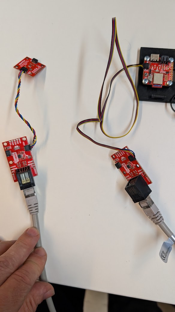

I want to do some remote (like 2-3 meter) temp/humidity logging and to that end I bought 2 Qwiicbus endpoints and BME280 Qwiic board. I connected the endpoints with a normal ethernet cable, put BME280 to the other end, and openlog artemis to the other end. But I cannot get the BME280 to be detected. The lights are on, but no sensor is detected by the Openlog Artemis. Is there something I am missing?

I added a picture of the connections. Basically Artemis β†’ QwiicBus Endpoint β†’ Ethernet cable β†’ QwiicBus Endpoint β†’ BME280
looks fine to me. Not many ideas, but some aspects to consider (maybe)
  • the Pull-up resistor are on the both endpoints as it should be.., but also on the BME280. Disable pull-up on the BME280 OR the endpoint connected to the BME280
  • Still try the scanner with the changes to enable the I2C power.
  • Try lower wire speed, maybe it helps.
  • You mentioned that the LED on the Endpoint to the BME280 is on. double check to be sure.
  • Try another ethernet cable
  • Any changes made to the endpoints ?
  • connect the BME280 to the other Qwiic connector on endpoint that is already connected to the Openlog board. See whether it works then?
Thank you for your reply! I checked the cable and found a defect from it. Tried another cable and now the measurement works. Thanks a lot!
