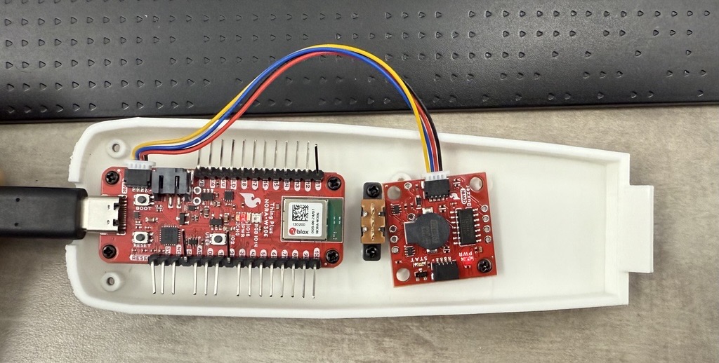

Hmm, I have a total of 3 buzzers purchased directly from you guys… none of them are working with the Thing Plus. I’m wondering if the board is somehow defective. I have tried a few different Qwiic cables as well. I attached an image of my setup just in case I’m missing something trivial.

I grabbed a Thing Plus NORA and a Qwiic Buzzer, ran the first example, which printed that the buzzer didn’t connect.
So I ran the I2C scan example, which printed 0x36 with the buzzer disconnected (expected, that’s the I2C Fuel Gauge address), and 0x34 with the buzzer connected (also expected, that’s its address). Curiously, I also got a few other spontaneous responses at 0x15, 0x67, and 0x0E, but I’m ignoring that for now.
Since the I2C scan worked correctly (mostly), I wonder if buzzer.begin() is incorrectly returning false, so my code above is a simple modification of the first example, which just continues even if buzzer.begin() returns false. On my end, it prints Begin: FAIL!, but the buzzer does actually make sound.
That worked! Good thinking. The Serial monitor does show “Begin: FAIL!” but it does buzz. I wonder why that function returns false only on the Nora. I would still like to figure some way to make sure the buzzer begins before proceeding, but I can probably figure something out. As long as the OLED works with the buzzer, I’m happy. Thanks for investigating
