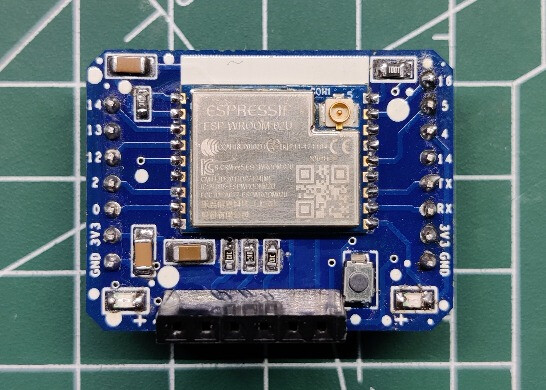

I have this board up and running with esphome and openthread. Unfortunately the onboard antenna is pretty weak. Is there a chance to connect an external one? The board doesn’t have a connector so I wonder if I can still solder that somehow.
Yes, this has been done before, but it is not trivial. Your board uses a PCB trace antenna.
There is no connector or antenna switch. That means no clean upgrade path exists. People usually cut the RF trace. Then they solder a coax pigtail. The shield goes to ground.
The center goes to the RF feed. This requires steady hands and RF experience.

It’s a bit bigger but this board has a connector for an external antenna.
The form factor would be good but I am running Thread, so I need an ESP32-C6
Just found this, don’t know if they break out the pins you need or not but it’s worth a try.
Tiny Matter-Native Board for Smart Home - XIAO ESP32C6 https://share.google/mfTnSYLxo0jJS06bF
You can solder a coax to the onboard antenna pad to add an external antenna, but it’s delicate and might affect performance just make sure to follow the board’s antenna layout carefully.
