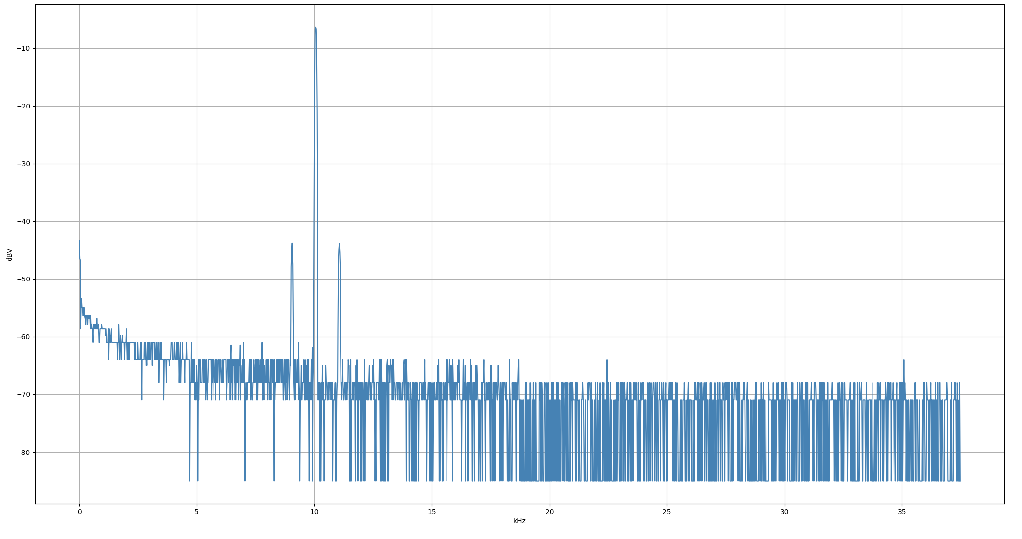

The following is a figure of a sampled AM modulated signal.
This was performed on a 10 kHz carrier signal with a 1 kHz AM modulation at 2.5% depth.
The sample rate was 1.2 MSPS, with 16× oversampling and 14-bit ADC precision mode.
The window used here is Flat-Top, and the FFT size was 4096 points.

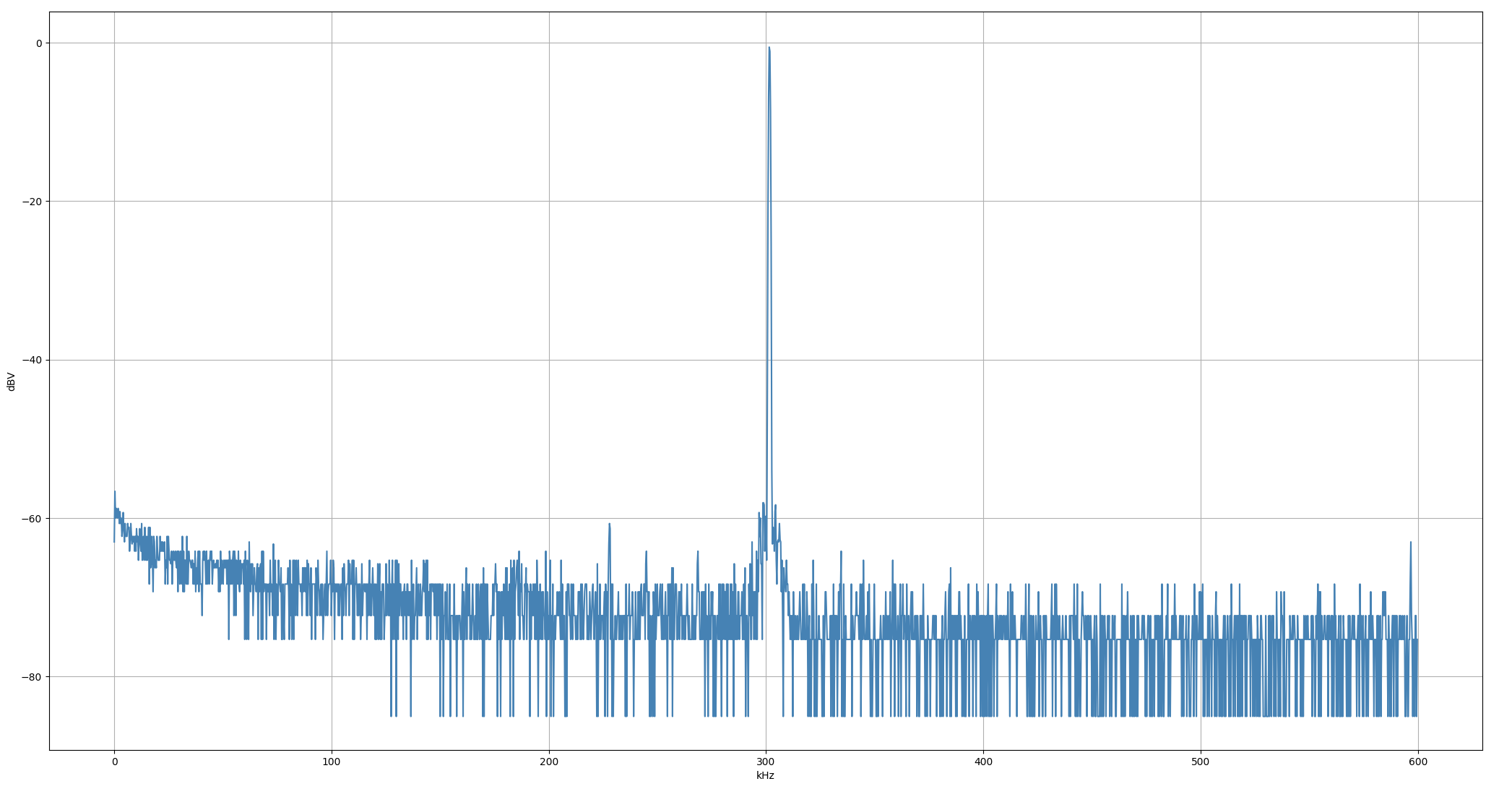

Below is an example of a 300 kHz sine wave at 2 Vpp.
Here, the sample rate is again 1.2 MSPS at 14-bit resolution with no oversampling, using a 4096-point FFT and a Blackman-Harris window.
