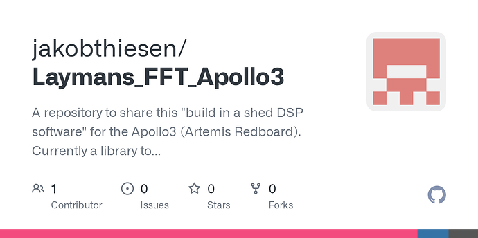

Unlock the full DSP potential of your RedBoard Artemis with Laymans_FFT! This all-in-one library suite lets you:
  • Sample up to 1.2 MHz at 14 bits using ADC + DMA.
  • Perform radix-2 FFTs with lightning-fast fixed-point math.
  • Stream real-time spectrum data to Python for live plotting.
  • Choose from 9 window types, including custom IMPERIAL windows for optimal resolution.
  • Boost the M4 core to 96 MHz for maximum performance.
Whether you’re measuring signals, learning DSP, or building a custom spectrum analyzer, this library gives you high-speed FFTs without the hassle.
You can access this at:
Follow the readme to implement the libraries.

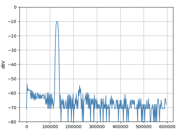

Here is a plot of 30 KHz FM modulated signal, sampled at 1.2 MSPS with 8 times oversampling at using the High Imperial Window, 16384 point fft.

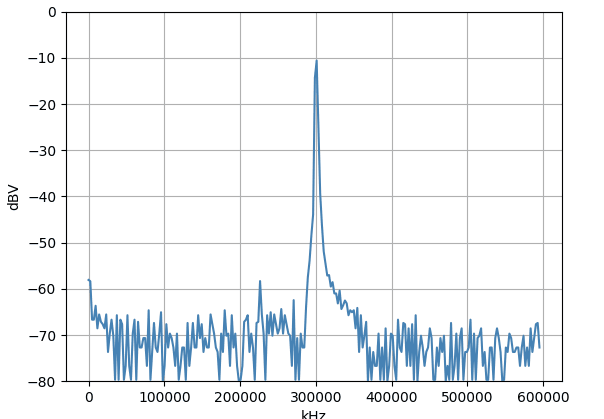

The following plot is of a function generator sweeping from 5 kHz to 595 KHz over 1s.
This is a 512 point fft using a flat-top window at 14 bit at 1.2 MSPS.
FrequencySweep
The following is FSK where a function generator is changing between 300 kHz and 400 kHz at an FSK rate if 5 Hz, sampled at 1.2 MSPS and 14 bits.
