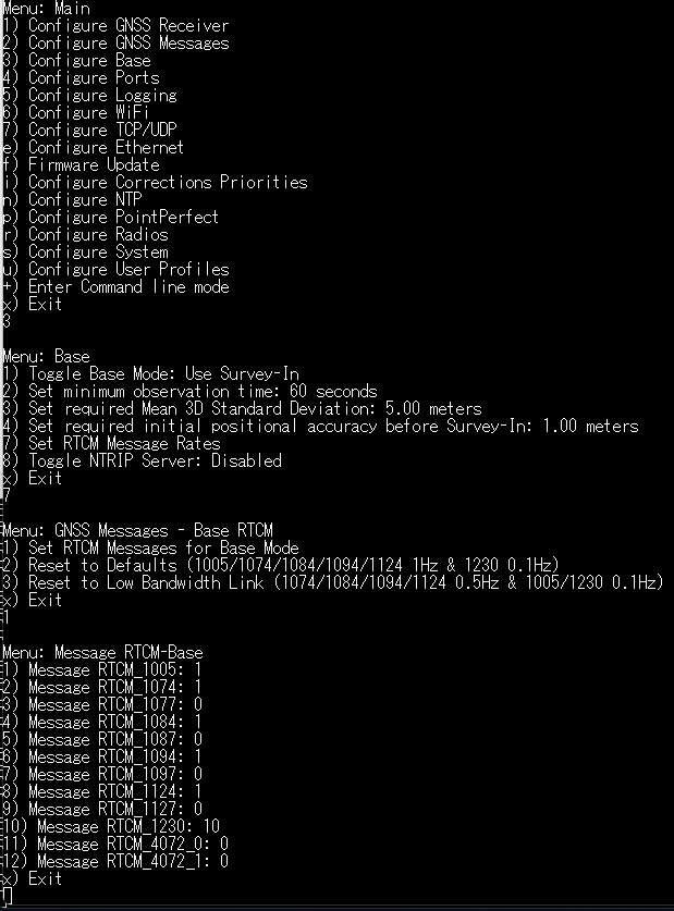

Thanks Doug (@doug_f ),
After a Factory Reset on EVK, I see the following in Base \ RTCM Messages:
It looks OK to me… Are you looking at the Rover RTCM Message rates? Those are all zero.

Thx Paul.
No, I was in to Base mode when I checked.
Maybe this explains it.
The path you took was Configure Base —> Set RTCM Message Rates, and your default rates appear correctly.
I was on the enable/disable RTCM messages (sorry, rushing I said “rates").
So, shouldn’t that menu show enabled messages rather than 0’s after doing a factoryReset?

Hi Doug (@doug_f ),
Menu 2 (Configure GNSS Messages), sub-menu 2 (Set RTCM Messages) sets the RTCM message rates for Rover. Is that what we’re discussing? Do we need to make it clearer that those are Rover rates, not Base rates?
Hope your travels go smoothly - all the best,
Hi Paul (@paulzc),
Yes.
Yes, I think that would help.
I’m flying blind since my EVK is not with me, but from the RTK Everywhere Main menu:
  • if you go down the “Configure Base” menu first, I agree - everything is clear.
  • If instead you go down the "Configure GNSS Messages” menu first, you don’t know which settings are for which mode(s).
