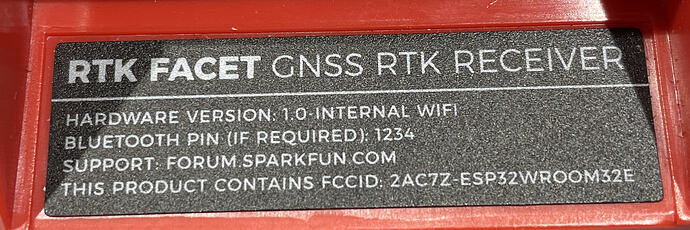

Thank you for the reply. I am not sure when we purchased it exactly, but it should be at least 1 year ago, probably longer. I can not reach the colleague, that ordered it but will try to reach him.

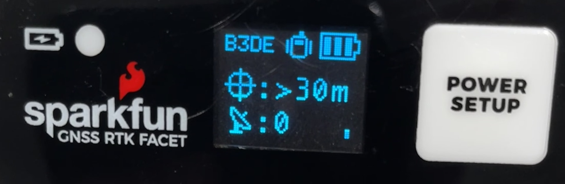

Some details I can read on the sticker and when powered on are visible in the attached photos:
Maybe those information help to trace the unit down?
But you suspect a failing battery? If so, I could also just order a replacement and test if it solves the issue.
I suspect display failure. We can replace the display for you if you’d like, or we can send you a replacement. Let us know which you’d prefer.
To confirm if it’s the display, connect USB cable, turn the unit on (as you’ve noted - the internal status LED is solid when powered on), and open a terminal at 115200bps. You should see serial activity. From there, do a system reset (‘s’ystem, ‘d’ebug, ‘r’eset). At the power-on-reset, the device will output a variety of logs including if the display was detected and online. If you can capture that output and post it, we can analyze it further.
