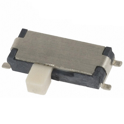

I have managed to get a RTK lock with our Postcard and Portability Shield with the help of Base Station information supplied through trk.geodnet.com. I also modified your 3d printable case model to accommodate the battery between the shields but have generated another problem for myself.
I broke the on/off power switch on the Portability Shield!! I have searched through the github/Kicad files for a part number but only found references to its dimensions.
Can you send me a Digikey park number for this switch?
Jeff
Hi Jeff,
I’m seeing CUS-12B SPDT_Slide_SMD_6.7x2.6mm:
Paul,
Thank you. I did not realize the leading characters were the part number.
