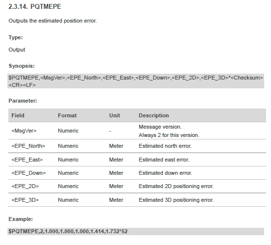

Yesterday, I once again tried evaluating the RTK performance when I realized that the unit does indeed receive correction data, the RTK LED does blink and then stay on when a fix solution has been found and the NMEA indicates an RTK Fix, but the accuracy does not change whatsoever.
The NMEA and PQTM DOPs and also real testing show a 0.3m accuracy, which stays the same with or RTK Fix or Float and with “only“ DGNSS, even the “error characteristics“ don’t seem to change when providing corrections.

giving me DOPs in the mm range,
DOPs are unit-less so I think you are confused.
Are you using our LG290P library? See get2Derror(). If not, please see the PQTMEPE command for the estimated error in meters.

Thank you for the clarification, the position error data is exactly what I was looking for, I indeed got the DOPs completely mixed up with errors, the DOPs mostly correlated with what I expected in meters of accuracy, so I didnt challenge that assumption :slight_smile:
As it is already very late, I will have to test the accuracy tomorrow, but I expect it to be as good as when I measured it on an app using the RTK Everywhere firmware, this correctly gave me the errors in mm.
