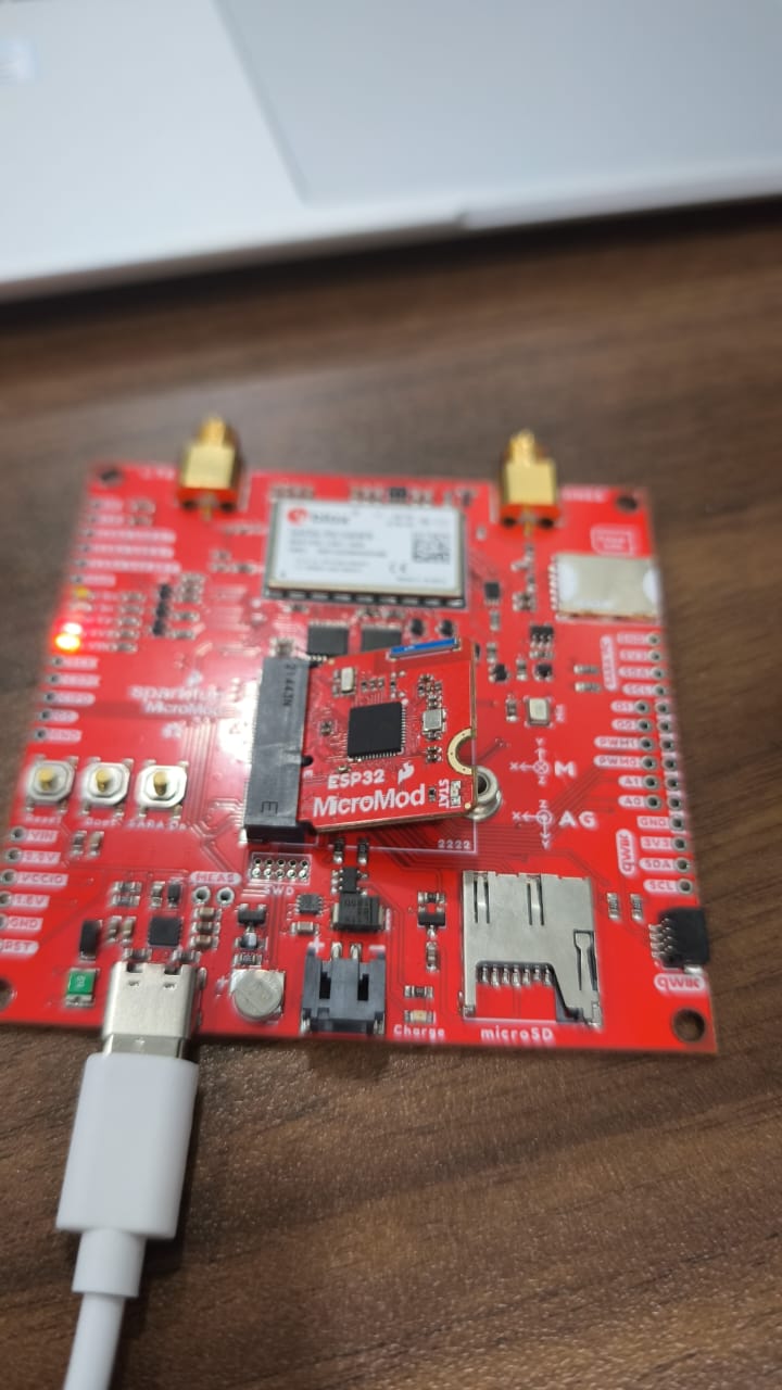

On the SARA R5 Sara On, 3.3V and V in LEDs are on and the indicator on update tool module is on but when I changed to ESP32 module the indicator on ESP32 is very dim and is not detected but PC
It might be worth inspecting the Micromod slot area/interface and ensure that there aren’t and bent/mis-soldered pins or something else awry…do both processor have the chamfered 45 degree edge on the pin-side (to make sliding it in easier)?

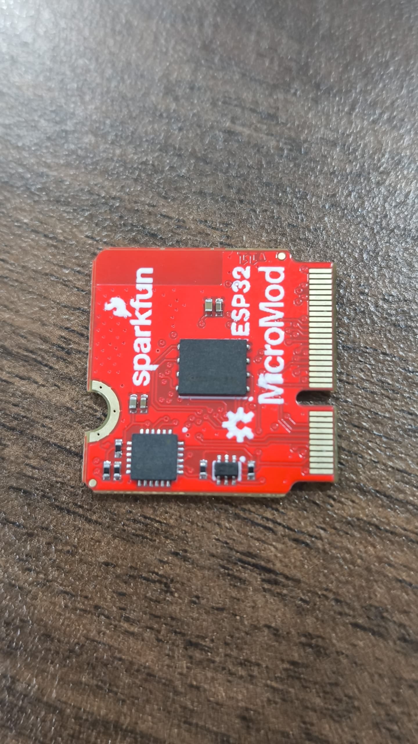

Attached here with the physical apearance. I dont see any bend on the board and on MicroMod Board Side I don’t think its M.2 port Issue because PC can detect the COM port with Update Tool but not ESP32
The chamfer looks good
To be clear, when in-use you affix the screw to hold the processor in-place as well, right?
Yes, both screw and unscrew don’t work
It sounds like a defective processor - Was it purchased from us? If so head over to Returns - SparkFun Electronics (contact vendor if purchased elsewhere) and we’ll get ya squared away
