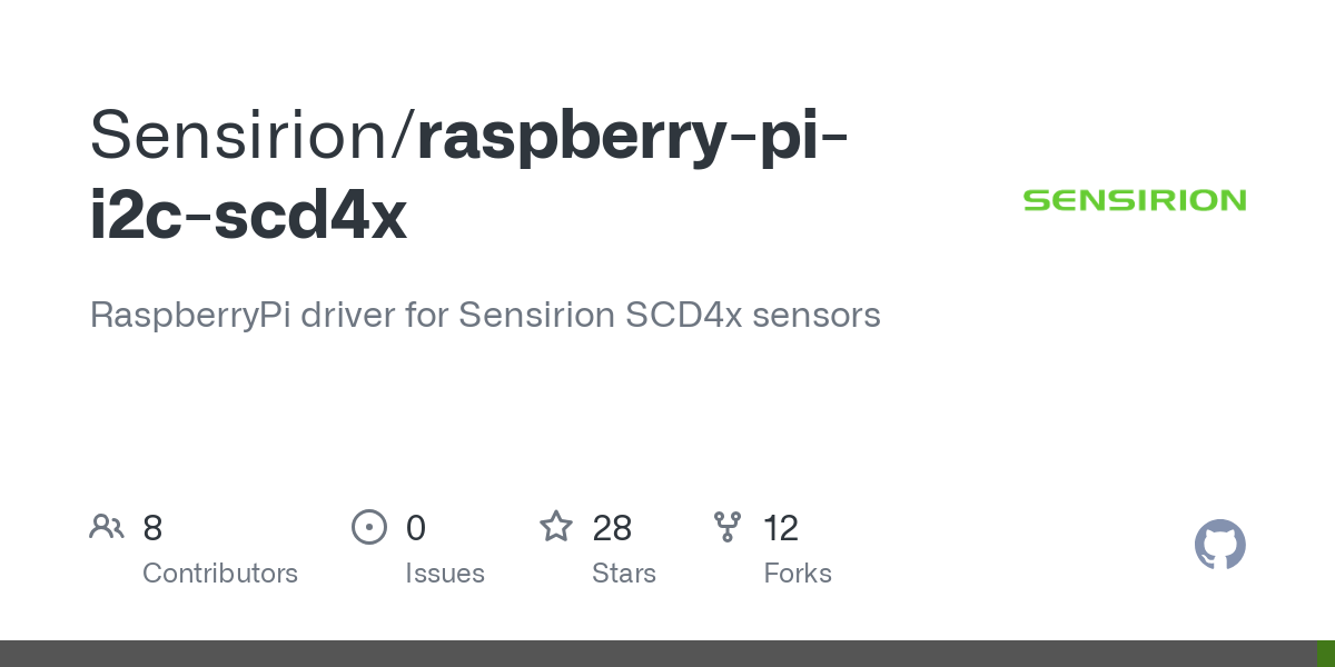

Tested on Raspberry Pi:
I ran scd4x_i2c_example_usage from
It shows serial number and stops
