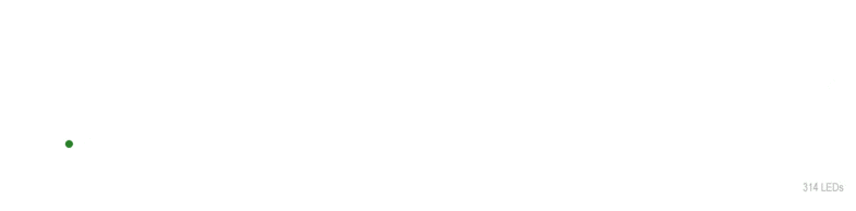

PS Animated gif of half of the desired display.
Http://www.allenpitts.com/electronics/M … 150626.gif
