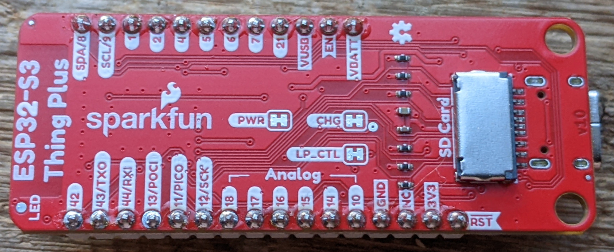

I’m fairly new to arduino and microcontrollers. I recently got a Sparkfun esp32 s3 thing plus and was starting to experiment and program it. It seemed to be working fine. I was only powering it with usb from the computer. I put everything away one night and the next day when I went to plug the usb cable in it did not work as expected. At first the yellow (charge led?) was flickering but that slowed and stopped. After futzing with it for a while I noticed a chip near the vbatt pin was getting very hot.
At this point the red led does not come on anymore. The yellow charge led sometimes blips when I plug in the usb cable.
Windows 10 computer only recognizes it as a “base system device” (no port number) now and Arduino IDE does not show the port it used to be on and will not connect to it.
I also tried to power it from the jst connector with a 1 cell lipo, but nothing.
I think something on the board has failed, what do you think?

I that thread it looks like the GND was tied the the 2s Lipo’s GND while being powered over usb…was that the case?
Yes, all the grounds were connected together.
Oh, just to clarify, the positive of the battery only powered the positive lead on the servo.
I’m suspecting that something was netted together power-wise that may have caused this, but: Was it purchased from us? If so head over to Return Policy - SparkFun Electronics (contact vendor if purchased elsewhere) and we’ll get ya squared away

I would try keeping all of the power and ground connections among different voltages wholly separated. The GND on the thing plus is unnecessary because it is getting a GND from the USB circuit
