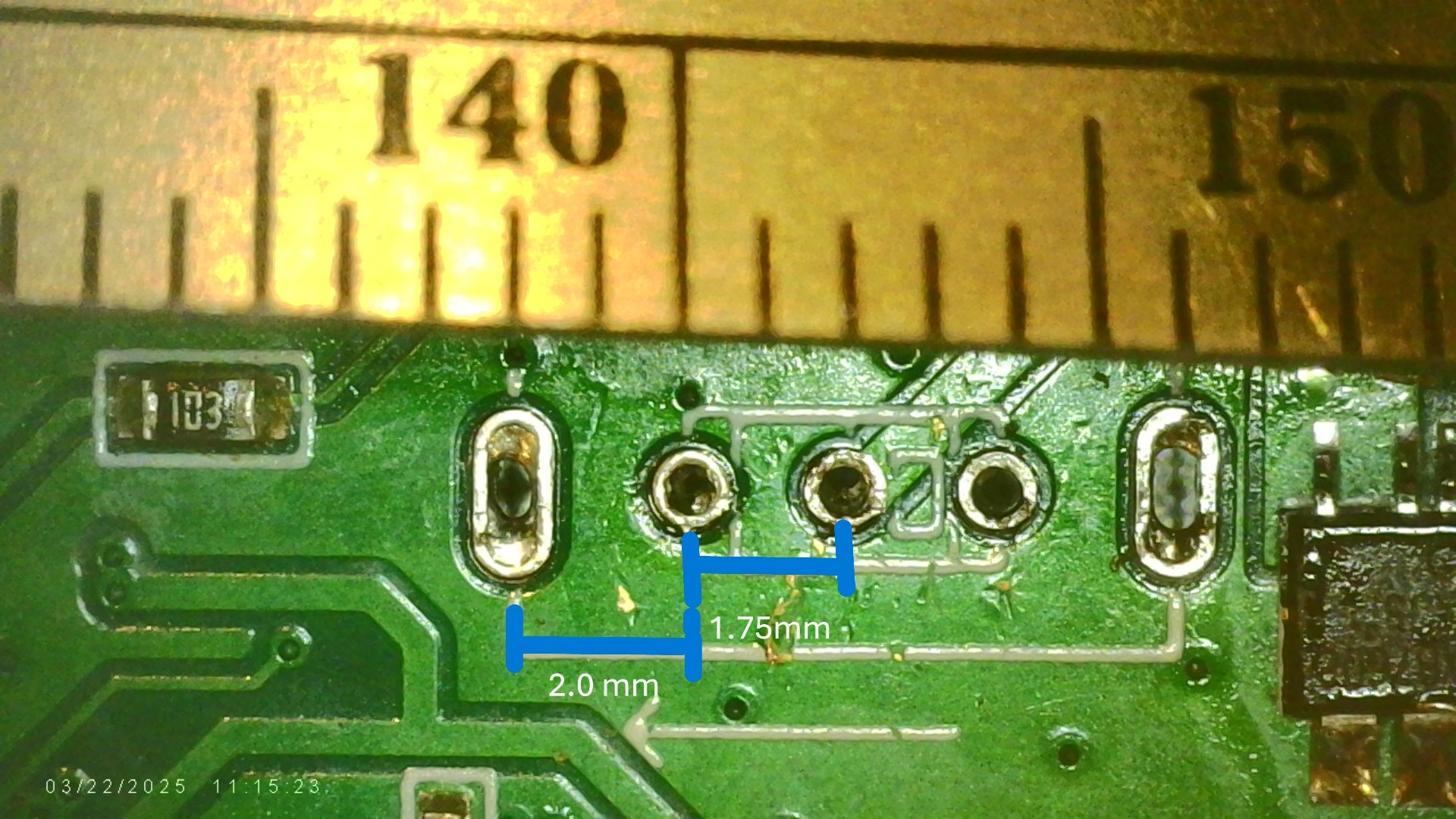

I am trying to rebuild a pcb and it needs a new slide switch (spdt through hole). It has a pin pitch of 1.75 mm which is not very common…i guess. Having trouble locating one. Any suggestions?
Digi-Key and Mouser both have really good selections of components, though I don’t see a way to sort by pin pitch/spacing…you might have to scroll/click a ton to find one :-/
You also might just grab a 1.0mm version with long legs and bend them to suit your spacing?
Hey TS-Russell, That worked!!! Thanks for mentioning it!
