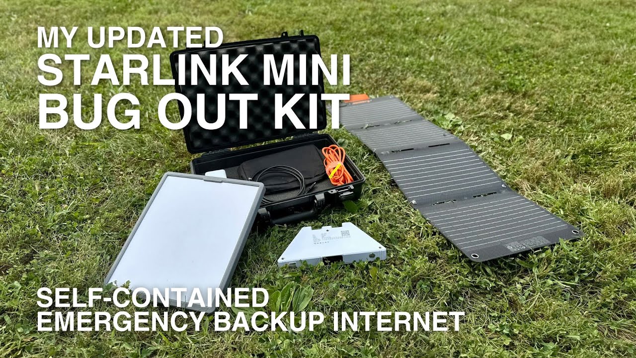

Hmmmm… Since Starlink is in the 10’s of GHz band(s) - that means a thin film solar panel is basically transparent to the Sat Comms. Could realistically fit a 10W Panel on a hard case this size.
Or using a folding panel that you remove from the case, the wattage can go way beyond the required power budget per workday.
The Mini has a DC input range of 12-48V, so we can select our favorite battery chemistry & construction for the Solar System, even simple 18650’s.

I found a video with a very impressive battery for the Starlink Mini
The PeakDo battery bank is expensive for the 99Wh capacity, but you can’t beat the formfactor. Also claims to accept up to 100W of charge :wink:
I still prefer LiFePO4 over the Li-Ons used in this PeakDo battery, especially when considering the operating temperatures inside a Black Case sitting in the Sunshine, with a 25W heater (Starlink) inside the case. We can Discharge up to 140°F, but 113°F is the max for Charging.
For me in the Southeast US, internal temps can reach >113° fairly easy in this scenario.
This is still absolutely serviceable, users just need consider the internal temp to be safe.
Open the lid, let the Solar Panel provide shade, etc, are easy things to do to protect whatever battery system is selected.
