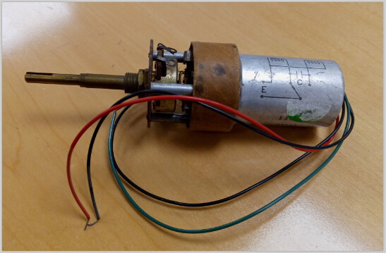

I happen to have this dusty ancestor on my desk right now. It performed a ‘somewhat’ similar function (one of them, anyway), the motor (silver can with wires) could actuate the potentiometer (terminals unpopulated in pic). There’s an additional reduction mech under the cardboard tube but the three brass gears I can see in the gap are very high quality. This must have cost a bundle to produce.
