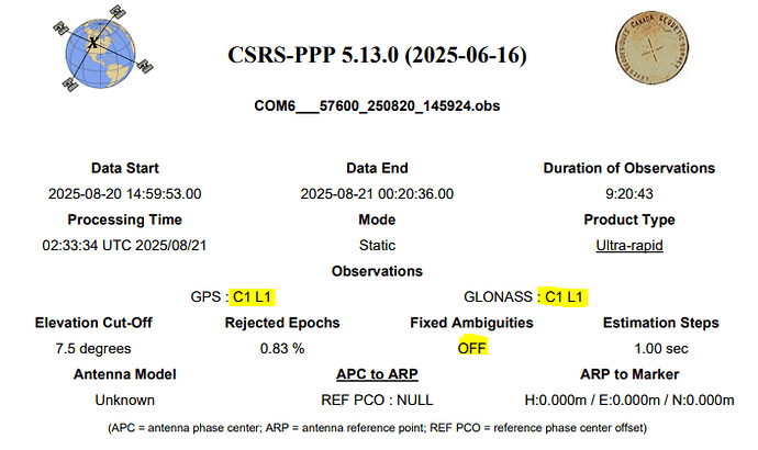

I recorded raw GNSS data in UBX format for about 10 hours, then converted it to RINEX (*.obs) using RTKLIB (RTKCONV).
After uploading the *.obs file to CSRS-PPP and OPUS for precise point positioning (PPP) post-processing, the returned solution shows a position error of over 1 meter, with relatively large uncertainties (1–3 m at 95%).
This is unexpected, because based on ZED-F9P specifications, I would expect centimeter-level accuracy in PPP (long session, dual-frequency).

Hello @Nguy_n_Vo_Ng_c_Th_ch ,
Could you please share the “Phase Ambiguity Status” data from the full CSRS report? It will help identify if your antenna and GNSS signal is causing the issue. You should see mostly green Fixed ambiguities:

I think it is clear you have bad GNSS signal reception. There are no Fixed Ambiguities in your data:
It looks like you lost signal intermittently for the last 2 hours. The data plots are broken several times:
I suggest trying again. I suggest taking your equipment to an area with a clear, unobstructed view of the sky. Collect data for perhaps 1 hour, and submit that to CSRS. If you have a car, you can collect data from your car with the antenna in the center of the roof.

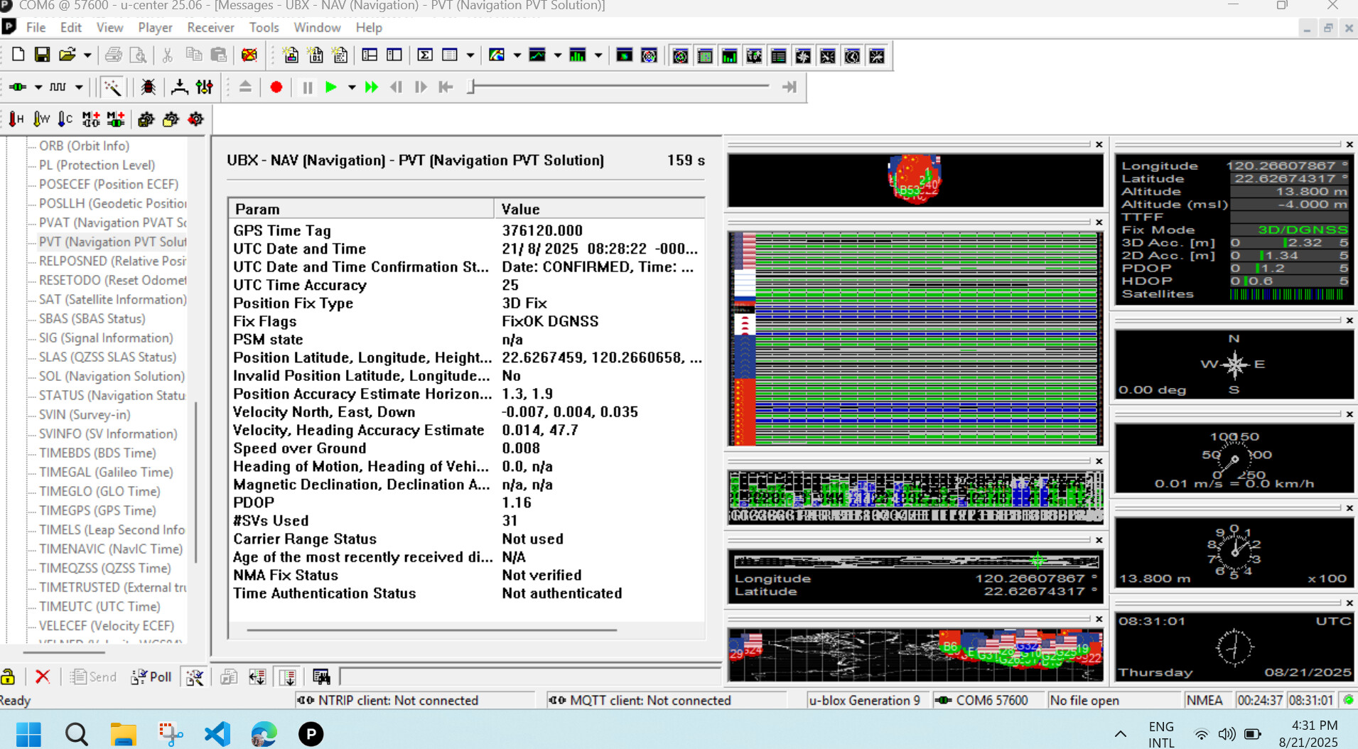

I am doing a survey like this picture. Please give me advice. Thank you.

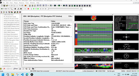

Please also post a better image of the satellite signal strengths. Your screenshot is not clear:

@Nguy_n_Vo_Ng_c_Th_ch , the data you posted is L1, not L1 + L2.
Your results are “as expected”.
Here’s an example of what you’re looking for.
Also note: you will never be able to determine the actual position of a Mark/Point with that type of antenna, unless you can find the Electrical Phase Center for it (doubtful). There are much better choices for PPP, such as this one on the SparkFun site.
