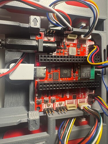

Can you share a photo of the board with the 4-pin colorful cables and motor cables disconnected? Sometimes the pins inside get bent during assembly and short on one another, or otherwise be disconnected like these examples
We’re looking for anything that seems amiss :wink:
I looked at both sides of the board and found 1 pin on the Distance (DIST) sensor bent/missing as you can see in the second picture. I attempted to attach a picture of the other side of the board however I am only allowed to attach one picture. Would this issue with the distance senor be cause for it not connecting to the computer?
Yep - you can try and straighten the pin out with tweezers or similar and attempt to get it straight enough for that connector to slip in without issue
I was able to straighten the Dist pin and replug the connector however there has been no change in connecting the XRP to XRP Code Editor. I am noticing in comparison to a video I watched that when I plug in the XRP, there is a solid red LED and no a green LED as I could see on the video. What would be the causes or reasons for this and could this potentially be our connectivity issue? I have attached a picture of the USB cable we are using (it is a DATA cable).

I’m not sure I understand the question. I am attaching a picture of what I am looking at. The switch position is turned to OFF, however nothing changes when it is switched to ON. Also, I have tried pressing the reset/boot buttons multiple times - including when prompted to do update Micropython.. still nothing..
The second red power LED on the other side of the USB connector (labeled MOT) should illuminate when the switch is in the ON position. If that does not happen, then there’s a problem. Though that should not prevent the XRP from connecting to XRPCode (when the SYS power LED is on, everything should work except the motors and servos).
