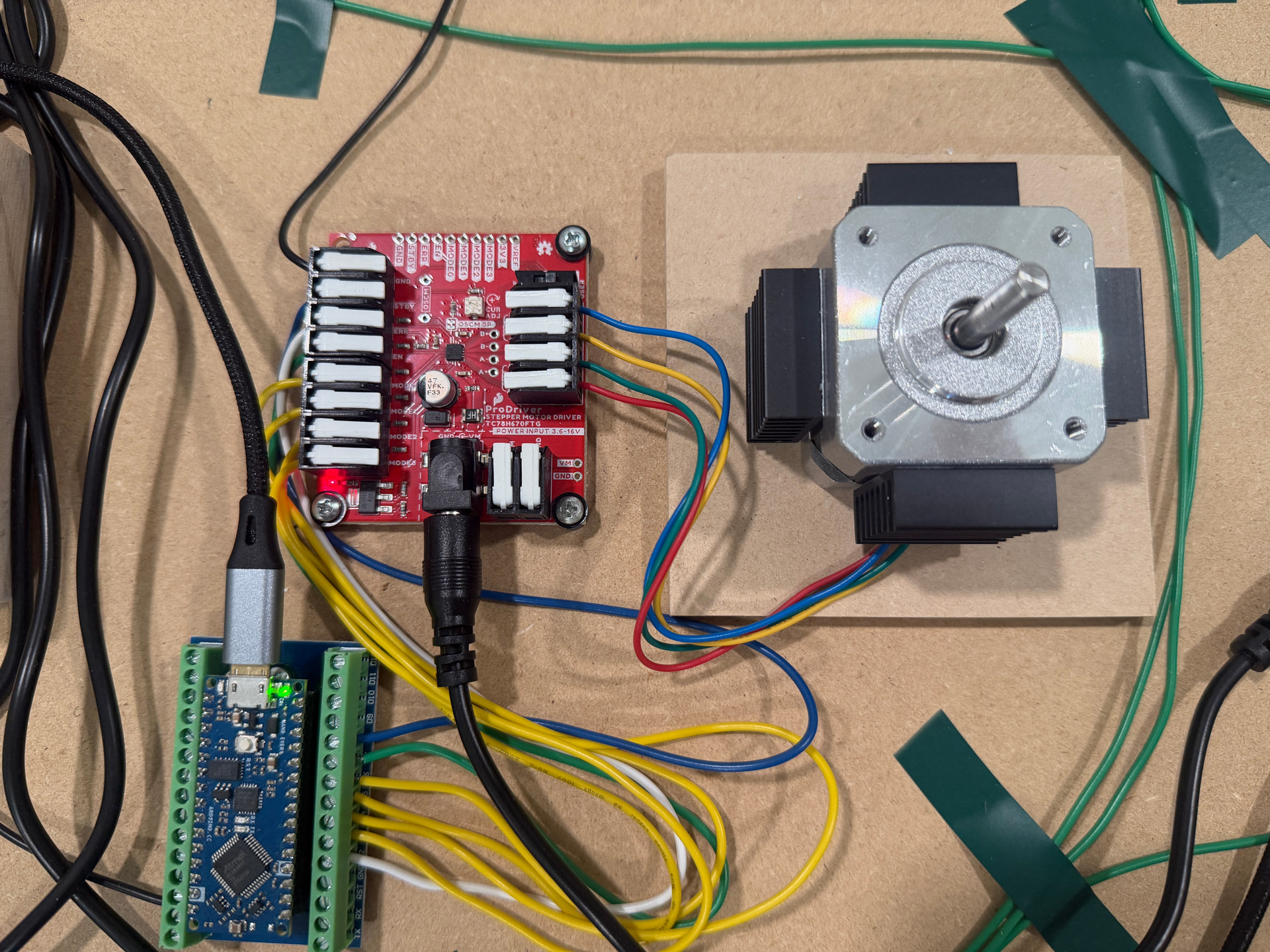

I have a project that needs 12 stepper motors and driver boards. I bought 15 of each to have some headroom, and I’m noticing only 9 are working. I could use some help identifying what’s wrong with the 3 installed motor+driver pairs that are not spinning as this failure rate seems unusually high.
Here is the setup:
  1. Stepper motor (heatsinks added on by me, but not really needed since the VREF is set very low for the payload I need to spin)
  2. Driver breakout board
  3. Arduino Nano Every controlling the breakout board
Here is what is identical on all 12 setups (9 working and 3 not):
  1. Arduino running SerialStep example

However, on the 3 failing setups:
  1. The motor makes stepping/clicking sounds, but the shaft does not spin
  2. If I measure VM → GND, I get 12.1N to 12.3V
  3. If I swap the motor for a known working one, the same driver+Arduino combo works fine

Id agree that this failure rate is pretty high here.
It sounds like the motors are trying to step and move the shaft but are being prevented from doing so.
With a problem motor disconnected can you freely move the shaft?
If the coils are mixed up via wiring this can happen but I am confident that is not the cause here since you have had much success with numerous other setups.
It is possible that the motors suffered some trauma during shipping. If a motor was say dropped on the shaft or smashed into something with the shaft I can see this kind of mechanical issue happening.
How was the shipping box? Was the packing material sufficient? Is there any obvious damage to the exterior of any problem motors?
  1. I can turn the shaft on a motor that’s not working but there is some physical resistance, it feels the same as one that works
  2. I have double checked the wiring, and even cut and stripped the motor lead lines to rule out a connection issue
  3. The shipping box didn’t seem damaged, but I suppose it’s hard to tell for sure what happened in transit

Try setting VREF to say 0.45V or 0.5V for a brief test with the sticky motors. The current is limited by Ohm’s Law (12V into 36 Ohms), you can’t do any damage. Maybe the VREF circuit is limiting the current lower than 330mA. By testing, briefly, at 0.45V or 0.5V you rule that out.
Hi Paul, I just ordered some more motors and driver boards. Looks like I really did just get 3 defective motors. How can we proceed with RMA?
