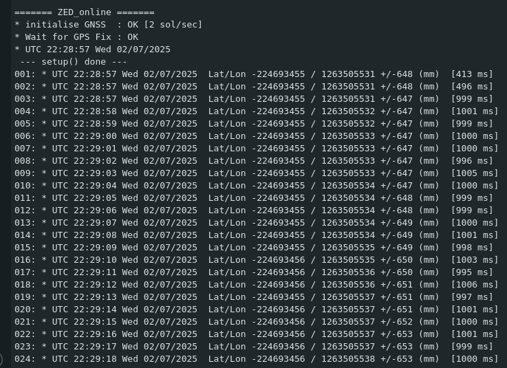

Well it turns out clive1’s early hunch about secondary issues was right. For some reason the ZED-F9P doesn’t like to use 921600 baud. If I reduce back to 115200 it works much better, although not ideal yet.
(Why 921600 I hear you say. Prior to this discussion I was developing a reliable feed from a public RTCM3 correction data stream into the ESP32 over WiFi, and forwarded over Serial into the Teensy for forwarding onto the ZED-F9P. This proved unreliable at first so I tried several fixes including buffering and the 921600 baud rates. In the end buffering was enough, even at 115200 to the ZED)
Here’s my code and output now. It curious that it starts out with < 500ms between readings (i.e. 2 solutions/sec) but settles at around 1 solution / sec.
That rate is OK for my purposes but I’d like to know why doesn’t it stay at 2/sec?
Note there are no calls to getPVT() or autoPVT() at all now:

Because you haven’t selected UBX-NAV-PVT to be output periodically?
As Clive says, making PVT periodic (setAutoPVT) will help a lot. Also, you need to restructure your code. Move all of the getYear() … getSecond() and getLatitude(), getLongitude() and getPositionAccuracy() inside a single if (gnss.getPVT()) { ... } statement. Remove those 1 millisecond timeouts: use getYear() not getYear(1).
Thanks Paul ( & Clive), I’m happy to do those changes but I’d like to know why I’m doing them … since AFAIK the output I’m seeing is working fine, so what difference will re-instating getPVT() make? Is there a Wiki or similar explaining how to use this library? From the AutoPVT example you shared I can see there’s a lot of capability, and I’d like to understand better.
PS: you keep mentioning 1 ms timeouts, sorry but I don’t know what you mean? I don’t have any in this code, and the line //if (t1 - t0 >= 500) { is commented out/disabled.
Perhaps you mean the delay(1000) instructions inside the while loops?
Because you are polling the PVT message, instead of it being periodic, the library polls (requests) each PVT message and waits (stalls) until it arrives. That can take up to the full navigation cycle to be delivered, 500ms in your case, depending on when the poll takes place.
Something in your code is causing the message to be polled twice in each cycle. I can’t see exactly where that is happening, but it is happening. It usually happens if you call (e.g.) getLatitude twice in one cycle. The library recognises that the Latitude is ā€˜stale’ - has been read before - and so sends a fresh poll and waits for fresh data.
If you restructure your code, and make PVT periodic, you will get better results.
The (1) in getYear(1) sets the timeout to 1ms. That is probably having undesirable side-effects…

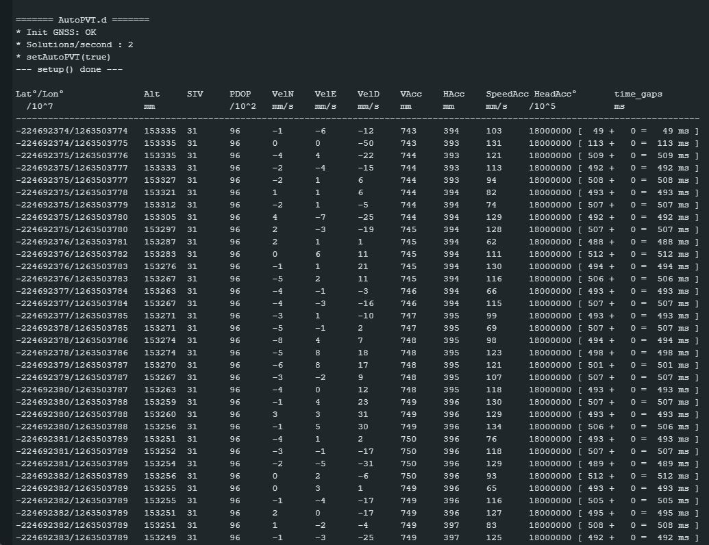

Ah! Got it! getPositionAccuracy polls the NAV-HPPOSECEF message, not the NAV-PVT message. It returns the HPPOSECEF pAcc (position accuracy) value. So, you are polling two messages each cycle: PVT and HPPOSECEF. Each will take (up to) 500ms to be returned.
If you replace getPositionAccuracy with getHorizontalAccEst, you will see a big improvement. getHorizontalAccEst returns the hAcc (horizontal accuracy estimate) from the PVT message.
And I just proved your theory/discovery correct! :slightly_smiling_face: using my version of the AutoPVT example clive1 pointed to earlier. It has all your suggestions in the code, including even this:
if (gnss.getPVT() && (!gnss.getInvalidLlh())) {
(I don’t know what getInvalidLlh() does. But it looks impressive)

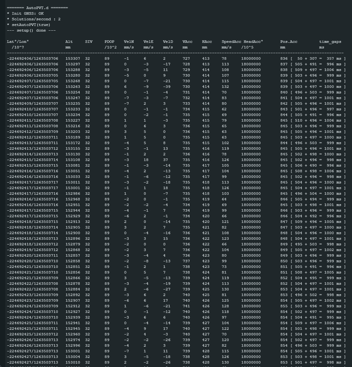

Following are 2 snapshots of the output from my AutoPVT code.
In the first I am calling both getHorizontalAccEst() and getPositionAccuracy in each loop(). Their values appear in the HAcc and Pos.Acc columns. Note the time gaps in the last 3 columns, summing to ~ 1 second or half the rate of 2 solutions/second I chose (as you predict)
In the Second I removed getPositionAccuracy while still calling getHorizontalAccEst()
Now the time gaps in the last 3 columns, summing to ~ 500ms, matching 2 solutions/second (again as you predicted)
Here is the loop() section of my code, after getPositionAccuracy was commented out. I’d like to know what all these mean … I can guess a few, but SIV has me stumped:

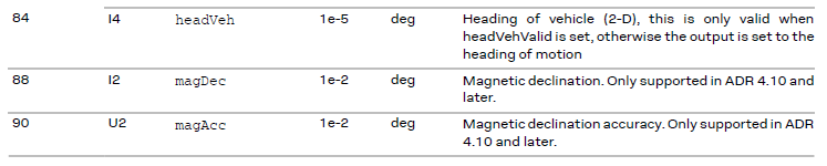

BTW note that if (gnss.getHeadVehValid()) { is never true (i.e headVeh, magDec and magAcc are never reported). compass readings perhaps?
ā€œSIVā€ means ā€œSatellites In Viewā€. It’s the wrong name. We kept it only for backward compatibility with older code. It’s actually numSV - the number of Space Vehicles used in the navigation solution.
You’re heading into Automotive Dead Reckoning territory there. That’s only applicable on some modules:
OK I may as well remove that headVeh section.

Is there an equivalent to autoPVT/getPVT for the NAV-HPPOSECEF message? I would like to use getPositionAccuracy as it seems to be a single 3D value, whereas getHorizontalAccEst is only 1D. Is it possible to get this info without the time penalty? Or is the normal usage to only poll it every, say, 10 seconds?
Yes, the Interface Description is the ultimate reference.
Yes, NAV-HPPOSECEF has full ā€œAutoā€ support in the library too: setAutoNAVHPPOSECEF etc.. There isn’t an example for ā€œAutoā€ HPPOSECEF, but there is a polling example.
For best results, call getPositionAccuracy from inside if (getNAVHPPOSECEF()) { ... }.
There’s no time penalty if you switch to periodic messages. getPVT() and getNAVHPPOSECEF() will independently return true when new data arrives. You can set the message rates independently to whatever you need. setAutoNAVHPPOSECEFrate(20) would set the message rate to one message every 20 navigation intervals: 10s in your case.
You might find the callbacks useful. They keep your code loop really clean and compact. See CallbackExample1_NAV_PVT.
