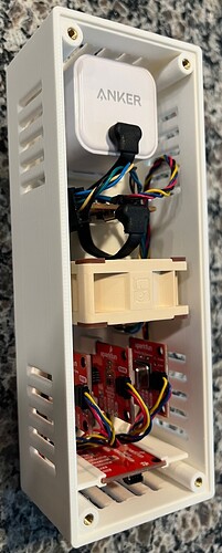

I have an AirGradient unit for monitoring the air quality in my home, but wanted something that would hang off a wall outlet. I discovered the SparkFun qwiic boards and went a bit overboard buying the most accurate temperature (TMP117), humidity (SHTC3), CO2 (SCD41) and barometric pressure (BMP581) sensors SparkFun has in this format.
Originally, the plan was to use a pi pico (or zero), but then I came across the Pocket ESP32-C6 and it fit in with the sensor boards too well to pass up.
Since I’d prefer not to burn down my house, I’m using an off-the-shelf Anker USB-C charger without any modification.
To make sure it doesn’t measure stale air, and to keep the heat from the power adapter and esp32 from influencing the sensors, I threw in a PWM-controlled 5V fan (yes, I have a Noctua problem). This runs at a silent speed, and even that is probably overkill. Unfortunately there aren’t qwiic fans (yet? :wink: ), so I did have to do some less pretty wiring to connect the fan to the esp32.
The enclosure was designed in Fusion and 3d-printed. I am still new to both. If you haven’t gotten a 3d printer, just do it. It really opens up a lot of possibilities.

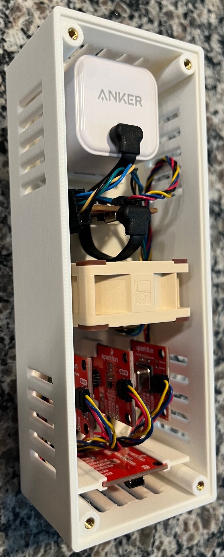

Here’s what the internals look like:
I’m using esphome to create the firmware. There’s a substantially larger amount of work I need to get to for recording and displaying the data from these sensors. That’s a whole other set of projects.
I wanted to throw this up in case it inspires someone else to think about building their own smart sensors. The esp32 boards and esphome make it a lot easier than you probably think it is. Let me know if you have any questions. Besides how much it cost. It cost too much. :laughing:

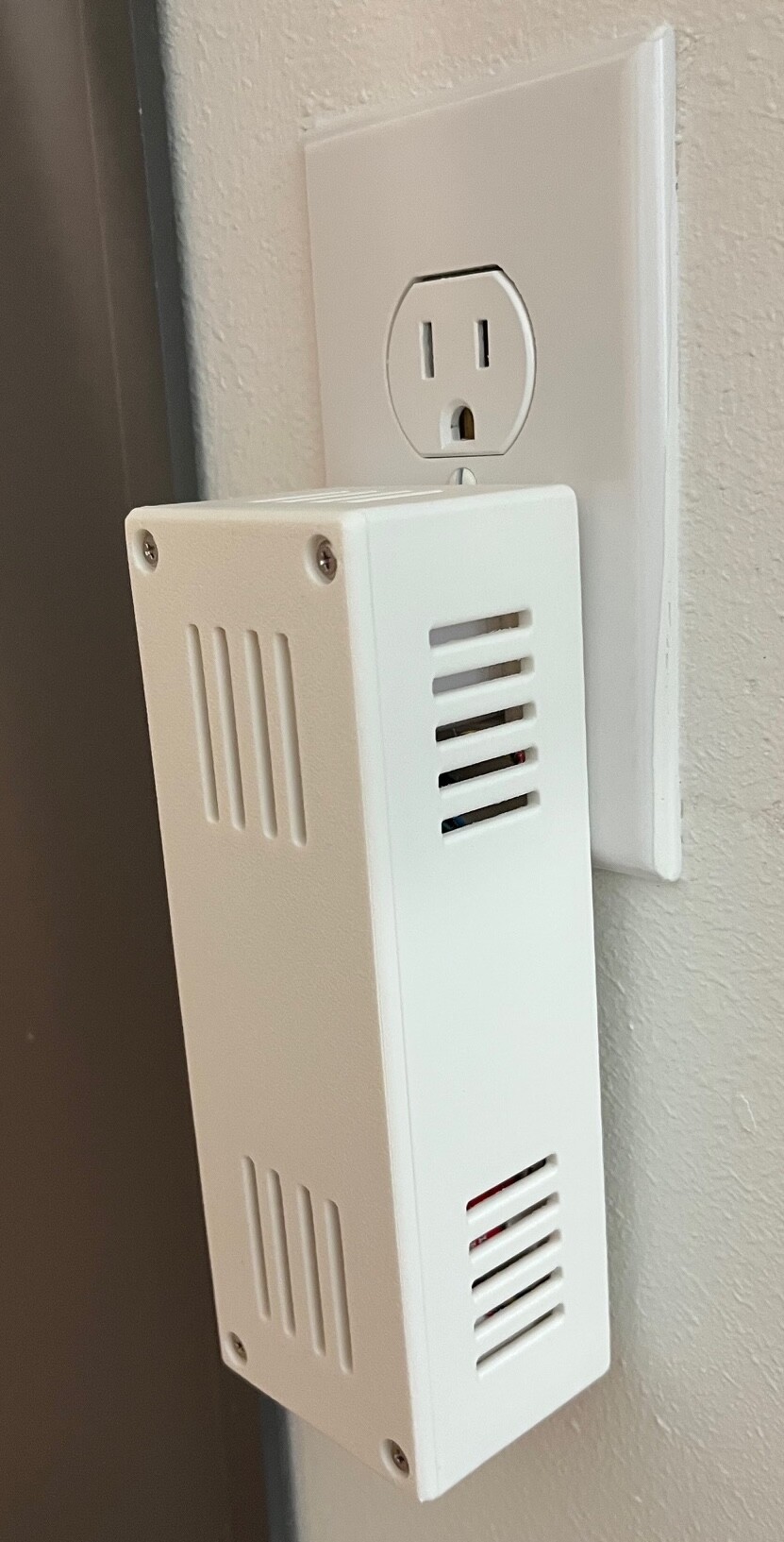

Here’s what it looks like with the cover on and plugged in:
