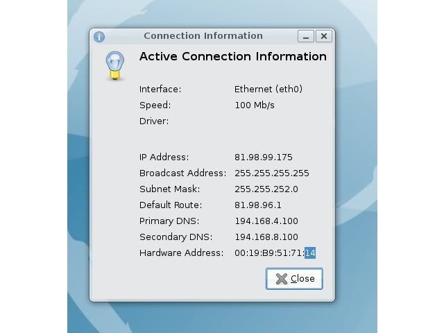

here is my eth0 details:
http://i276.photobucket.com/albums/kk5/ … titled.jpg
regards

first of all you need connection to your network… use:
  1. ethernet switch or 2) second network card + linux software ethernet bridge
I use variant 2) :slight_smile:
then on your board execure command:
route add default gw
get default route from your screenshot :slight_smile: (81.98.96.1)
then open file /etc/resolv.conf and add lines:
nameserver
nameserver
where DNS IP address get from your screenshot :slight_smile:
and then configure IP address of your board:
ifconfig eth0 netmask up
I dont know correct IP address in your situation =(
in my case:
netmask 255.255.255.0
ip address 192.168.0.20 on board, main computer 192.168.0.1, router IP - 192.168.0.5
I use my router IP as default gw… and this works FINE :)))

i did all the steps. (connecting ethernet from my modem to board directly)
but in the beginning when :
cs-e9302:~# route add default gw 81.98.96.1
SIOCADDRT: Network is unreachable
any hints?

how could i know mine? is it different than 81.98.99.175 (according to image when connected to PC)
