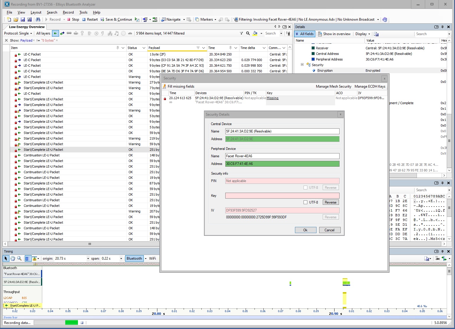

I am attempting to monitor the Facet BLE traffic to SW Maps and notice that the data is encrypted. Can you provide the security key? Thanks.
Ellisys Vanguard Security Entry Dialog
Update: Turns out that SW Maps is requesting sessions keys for the link via LL_ENC_REQ, but the Facet will also support a non-encrypted connection.
Excellent! Glad to hear
