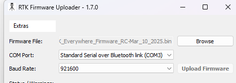

I’m running Mar_10 RC firmware.

Even after changing the caster settings exactly as you show them, it’s impossible to connect. I’ve also been running the March 10 firmware, and nothing works, Tera Term tells me that it’s not possible to connect.
