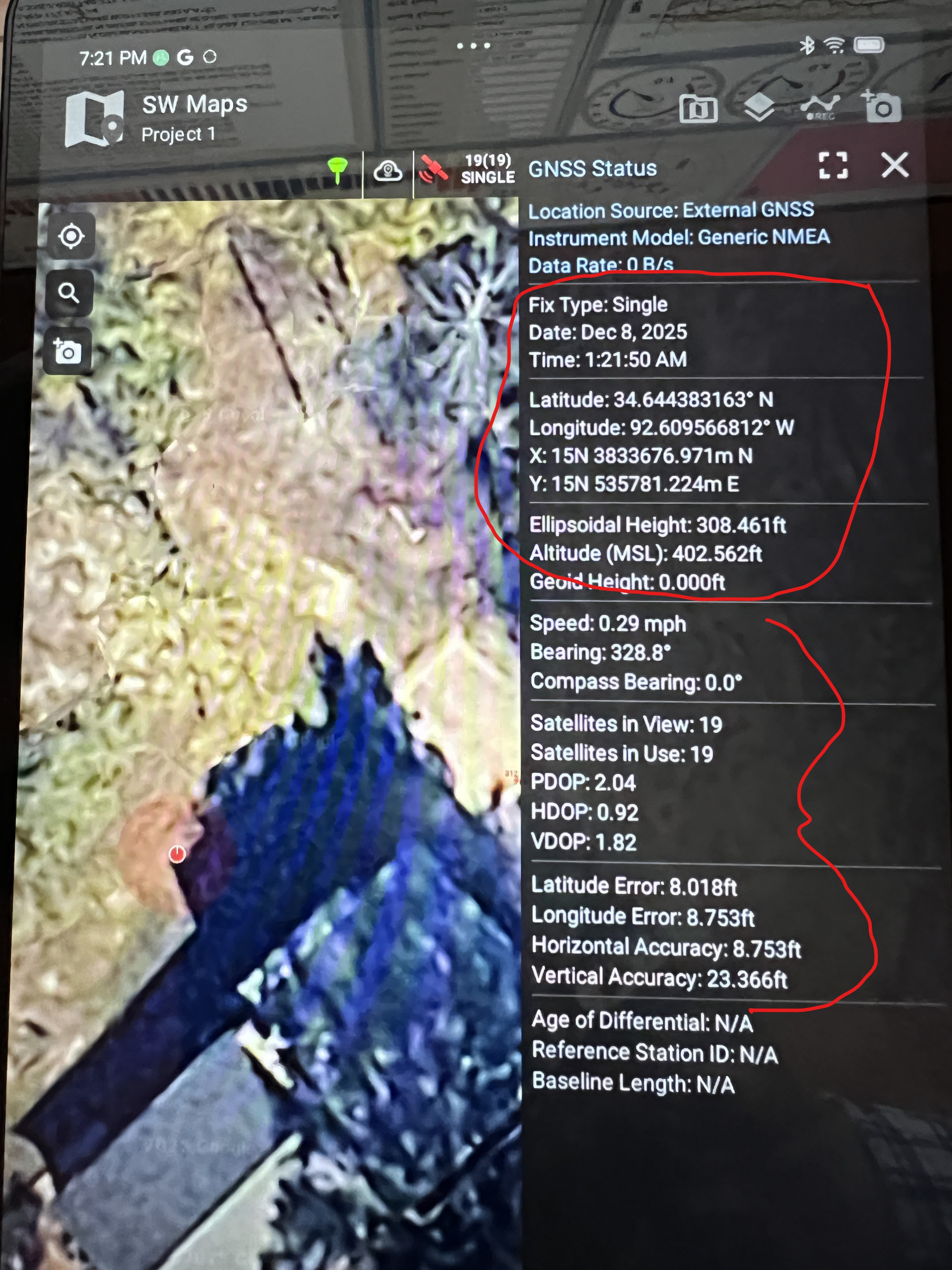

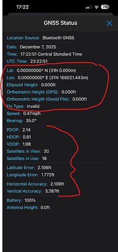

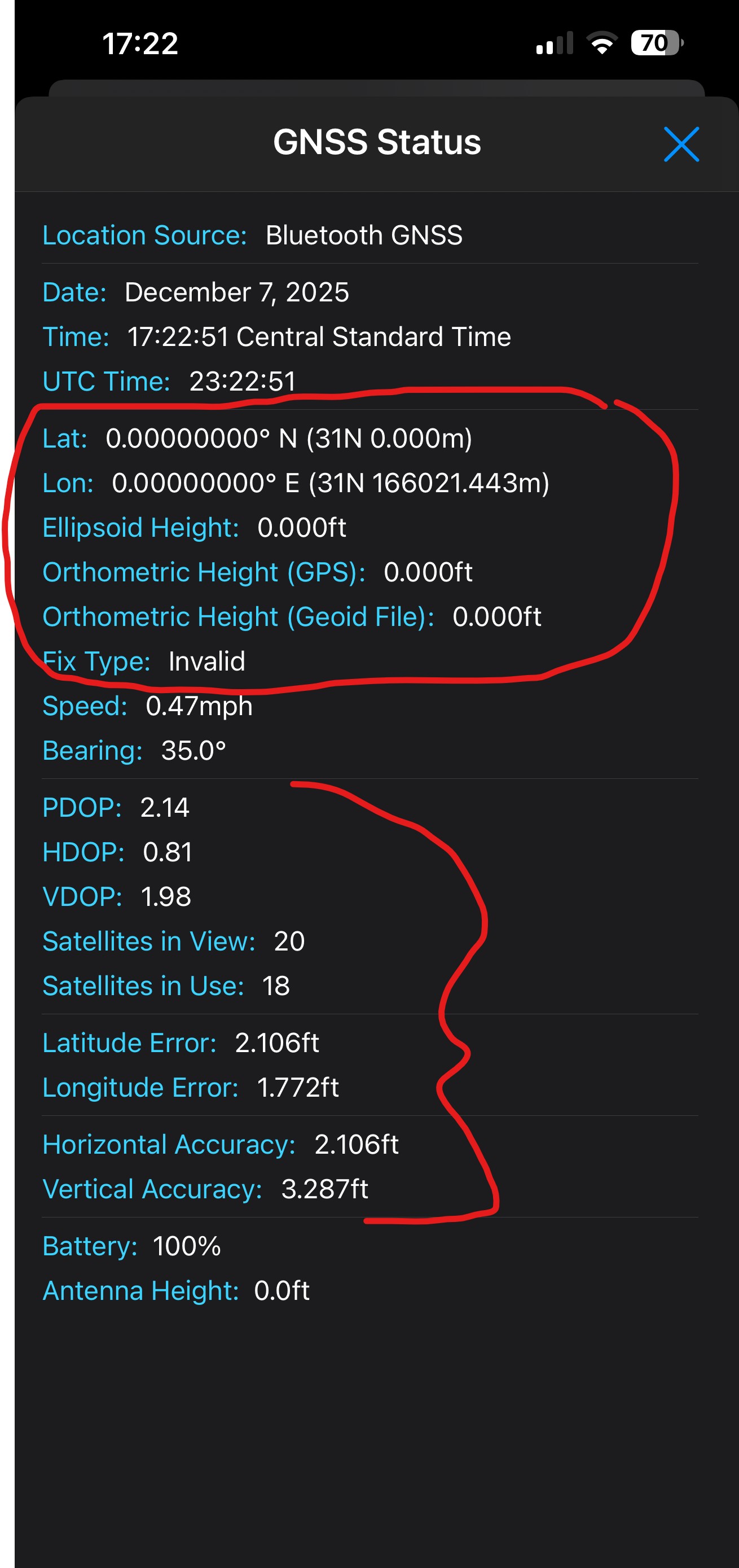

Today, I updated the RTK Everywhere Firmware from Version 2.1 to 2.3. Now, I do not receive Latitude and Longitude readings when using SW Maps on my iPhone nor on my iPad (although I did before the update).
However, SW Maps works fine on my Android tablet. (See photos.)
Any hints on a possible fix?

I just updated a Postcard to V2.3 and had the same experience as you.
SW Maps iOS V1.2.4

The BLE connection is fine, and even the metadata is coming through…but something is cross-wired with the position on SW Maps V1.2.4.
May be a red herring, but I used an iOS app named “BLESerial nRF” to capture the NMEA output from the Postcard (see screenshot photo below).
The app offers Display Options for Separation of Incoming Messages. I chose “After newline character” as opposed to “After each message”.
It appears that a “newline character” is not being sent at the end of CGA sentences, possibly causing the RMC sentences to be missed???
