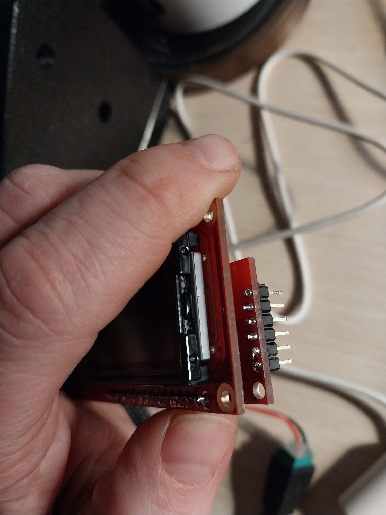

There could also be some issue with soldering, do you mind sharing a photo?

Hopefully these are the solder points you’re asking for. I can only do one photo at a time, so let me know if there was something else you need.

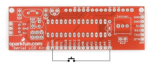

I suppose it is possible that the DTR pin on the FTDI basic could have malfunctioned somehow. Maybe from ESD?
Essentially the ATMega328 might not be getting the reset signal it needs for the code to upload.
Might be worth trying another programmer at this point as that would be the cheapest and most simple next step.
You can add your own reset button (see image below), or just hold a jumper wire between the ground and reset pins as indicated and pull the wire once the IDE starts uploading.

What ftdi are you using? Can you post a photo showing how the ftdi is connected to your board?
It’s the FTDI basic 5V from Sparkfun. I’m aware it has to be oriented to match the GND vs the DTR, and it is.
