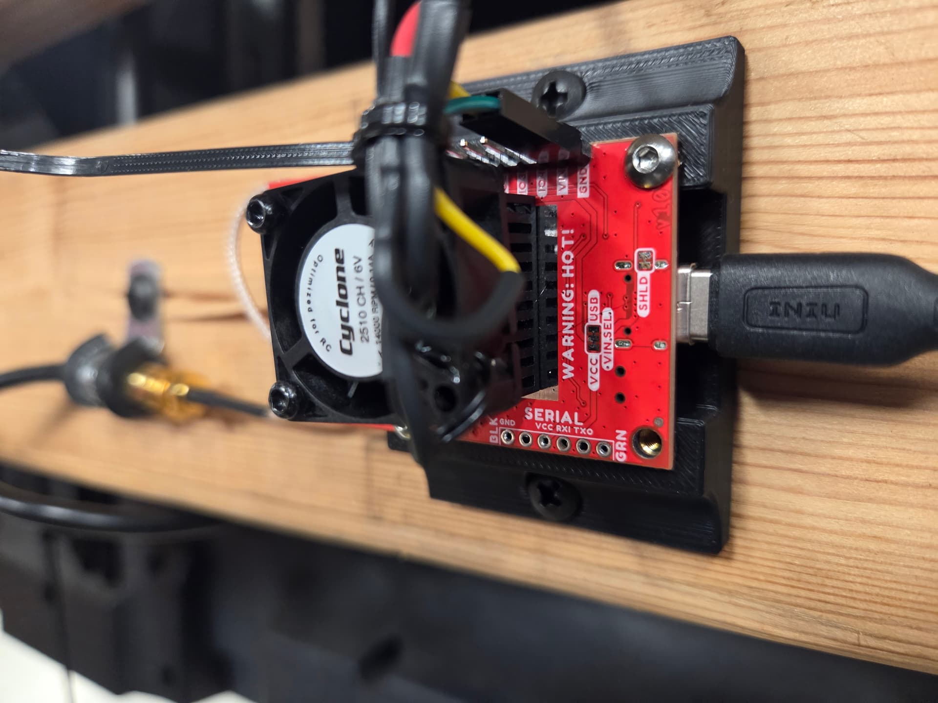

I’m using this antenna with the board powered by the computer over USB-C and I’m barely getting a 4” read distance. Is there something I need to do in order to increase the read distance?
Are you using a beefy power supply and increased the dB power for the reader?
I have a 5v 2a power supply wired into the VIN/Ground pins. I see there are pads on the face of the board, do I have to jump those to use an external power supply? I have a heatsink with a fan on the board. I have the board set to use 27db. I found some different tags than what’s on the SF site and they read a little further away (about 2’) but it’s no where near the 10’ I was hoping for. I have the tags on the outside of a plastic fearing with nothing in-between the antenna and the tag.
Can you share a photo of the setup & wiring? Specifically the soldering/pin connections
Of course :slight_smile:
make sure you have a solid /stable power supply. Not a wall wart… The reader works in bursts and needs a supply that can deliver peek / pulse power (like a laboratory supply)
