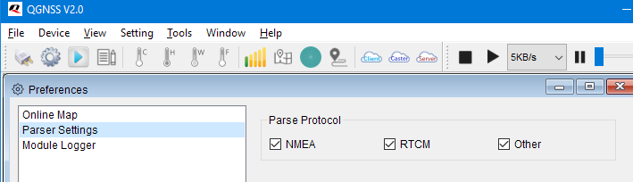

The problem im running into at the moment is attempting to find the exact location of my base station. I need to be able to utilize the “Survey-In” mode of the quatcel chip so that I can run the survey for a couple hours to get the exact gps location of the antenna for the base station.
When attempting to put my board into base station mode, (and then eventually in survey-in mode) I run into the issue where the serial port just starts spitting out gibberish (maybe binary?) immediately after putting the unit in base station mode and then saving and rebooting.

Usually when I see characters like that from a serial comm there’s something amiss in the baud settings or there’s an overflow of some kind
Can you successfully send other commands? Software Overview - SparkFun LG290P Quadband GNSS RTK Breakout Hookup Guide (example is a bit scrolled down that section). Also make sure the right COM port is selected
Finally: what firmware version are you running?
After each command run savepar & reboot
note that if you have the latest fw, the module receives the specific command (not all) only on the current port;note there are three uart…
Check baud_rate and note that in base_mode it outputs rtcm, so U need an rtcm parser after checked baud & port on module & client_terminal

I see, honestly I just had the board hooked up to a raspberry pi which was sending it commands through pyserial. I wouldn’t be surprised if the board was not a fan of formatting or something or the other with the way I was sending it commands. I will try to do the setup via the actual quatcel software this time. If I still run into issues I will check the firmware and give you a more detailed explanation of my process using QGNSS along with the firmware version.
