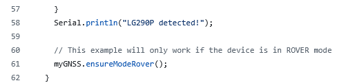

I’ve recently bought the SparkFun Quadband GNSS RTK Breakout - LG290P (Qwiic) and the GNSS Multi-Band L1/L2/L5 Helical Antenna (SMA). I’ve successfully connected it to a KeeYees ESP32S ESP32 Development Board and I’ve ran the provided Position.Velocity.Time.ino example:

Could you please tell why after 15 minutes being outdoors and with 11 satellites in view, it still is not displaying the Latitude and Longitude data? May the SparkFun LG290P (or the antena) be damage or malfunctioning? Does a “cold start” take more than 15 minutes? How can I make it properly run it?

If trouble open a comm. terminal (perhaps need usb or ttl conv)
and send
$PQTMRESTOREPAR*13
$PQTMSAVEPAR*5A
reboot
bamarcant, I’ve followed your recommendation (step-by-step) and now I’m getting the Latitude and Longitude data. Thank you SO much! :slight_smile:

Hi Luis, these are quectel commands here the v1 spec
and here the latest docs & fw. and here
after pqtm restore par the module default in rover mode…
pqtm prefix refers to quectel comm.
par suffix derive from Airoha pair comm. and remained into …
…restores the parameters (Clear the current configuration and restore the default settings)
