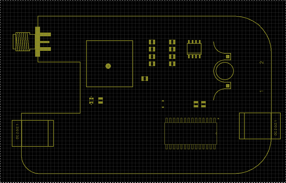

Having already wired up my board (except the ground pour), here is what my tDocu layer looks like:
http://i.imgur.com/fhXpZQm.png
I don’t want to change the entire layer, just the outline of the board.
How can I extract that shape to use for the pour? And how can I use that shape to make a dxf (or is there a better way to indicate to a fab that I want that shape?)
You can use the copy and paste to get the outline for the ground pour. You select just one segment at a time to change it… It’s the button that has a wrench on it… Select layer, then the dimension layer and click on the segments you want to change.
