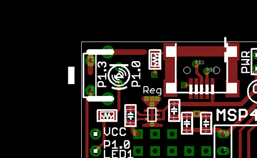

Along those lines, how do we add symbols, like a diode symbol, to the silk screen?
You draw them, using lines, rectangles, arcs, polygons, and etc. usually within the library part definition for the relevant component. For instance, I got tired of not being able to tell my SMT resistors from my SMT capacitors and made new separate packages:
[<LINK_TEXT text=“http://farm4.static.flickr.com/3341/570 … fe63db.jpg”>http://farm4.static.flickr.com/3341/5708838055_a36afe63db.jpg</LINK_TEXT>
You have to pay some attention to how much will show on the actual PCB, once the silkscreen layers are clipped to the non-exposed-copper areas (xCream), and you can be exacting about putting some of the drawing on tPlace (actual silkscreen, usually) and some on tDocu (only shown in editor) if you want…](modifiedRCL | Note that R & C component packages have been m… | Flickr)
