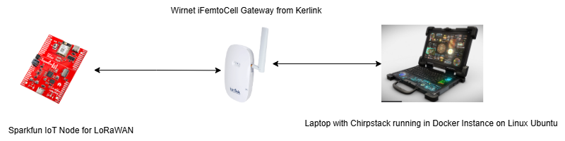

Hello Dilshana,
I don’t have the gateway from Digi International, that’s the reason I’m trying to connect throw other Gateway. The board was a gifts during the Congress in Barcelona.
This is the diagram of I’m doing.
